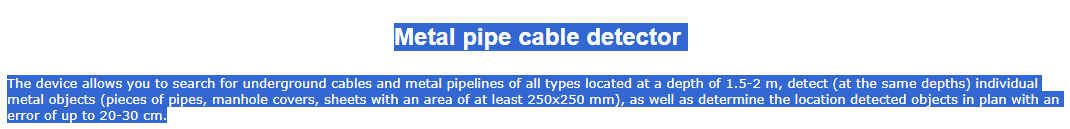

            to eliminate ground effect the coils are lifted 1m above the soil.
            Click image for larger version  Name:	image.png Views:	0 Size:	211.4 KB ID:	426651
              Thanks Altra and Pito,
              I believe (well hope) ground mineralisation in the area is pretty low. I think I’ll give this a go. If it doesn’t work I’ll probably convert it to a skid mount and try using it elsewhere.
