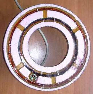

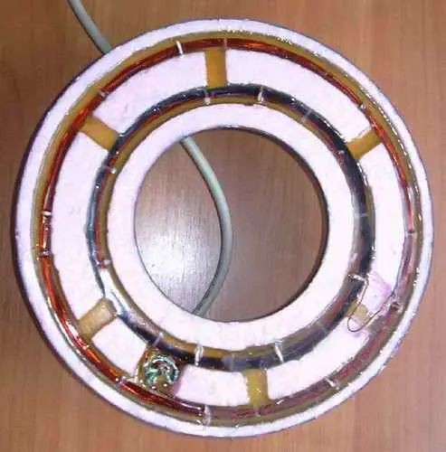

                Hello, you can not fill the entire sensor with epoxy resin.I pour a thin layer, then put the foam, which does not dissolve with epoxy, then pour the resin again.The sensor turns out to be lightweight and durable.The archive contains photos of the manufacturing stages of the sensor.

                  In terms of weight reduction, foam is a good option. However, in areas where temperature reaches above 40C or 100F, coil's specifications tend to slightly change due to the elasticity in foam, which allows the copper wire to stretch out a bit, although it is an excellent insulator against heat.
                  I would make it as an "epoxy sandwich" where the buns are the foam layers. This way the coil does not get much of a "wiggle room" to stretch.
                  This idea could work, or at least be tolerable only when making a PI mono coil. Not IB coil such that you need it to be balanced and fixed for life.

                    I forgot to add that when winding the coils, I also soaked them with epoxy resin and waited a week, during which time they dried well. A week or more passed between the filling stages, the foam only serves as a filler, if everything is filled with epoxy, then the sensor will be very heavy

                          only serves as a filler = or temperature stabilizer

                              using it instead of the foam = no, foam stay as on picture Post # 13, body filler is replacing epoxy.
