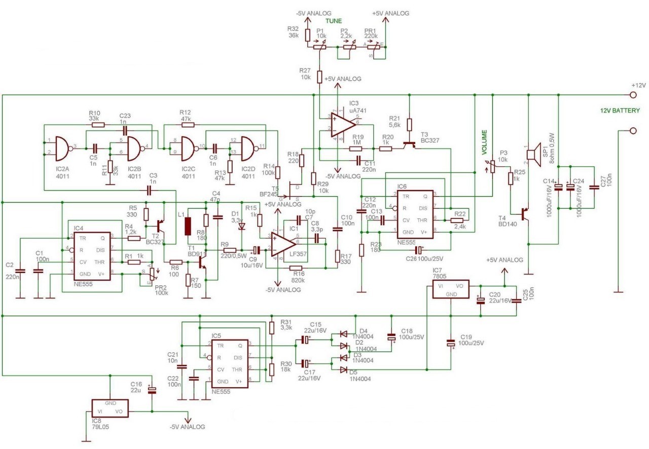

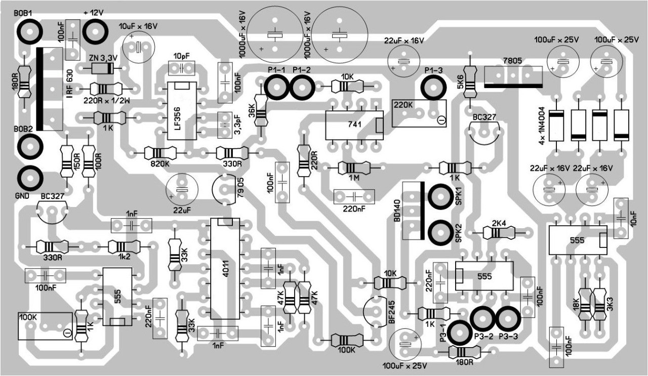

    I maked a PI Polones (AVT–5196). I upload some attachments

        Not sure whether you have notice it. The PI Polones is a Pulse Induction (PI) detector and the TDSL is a Very Low Frequency (VLF) detector. This are two different detector design concepts. To make a coil (Mono) for a PI Polones you usually do not need any "nulling" and or move around "loops".
          Not an issue, a coplanar coil on a PI would improve sensitivity to small items while maintaining depth on larger items, since the Rx coil inductance can be increased to 4 or 500uH. Easily providing a much reduced sample time, and it may even reduce some ground noise, similar to a DD. A plus if you seek jewelry or small coins.
            Hi Kev,
            yes, you can use a coplanar coil on a PI detector. But for the PI Polones you need to modify the circuit a little bit so that you have a separate RX & TX-coil connections. If you do that, you also do not need "nulling" the coil.

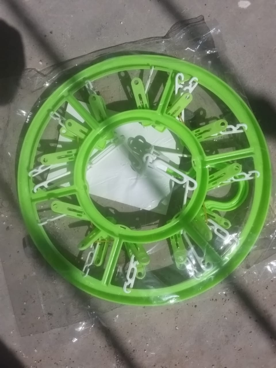

                        Finding small jewelry is what I really want! because I have a case circular with two circles 25cm outside and 12cm inside of a clothesline. This fits for both coils and I want it to take advantage of the smaller coil to find small objects.
                        So, if I make the Surf Detector dual field coil omitting the copper shielding (if I don't put it on), will it work for small objects?

                              Hi all,
                              I would prefer to construct a dual-field coil rather than a co-planar coil. It is simpler to make. The green cloth hanger is quite nice as a coil housing. I have seen other videos where a Filippino guy used these kind as well for his coil housing.​
