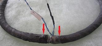

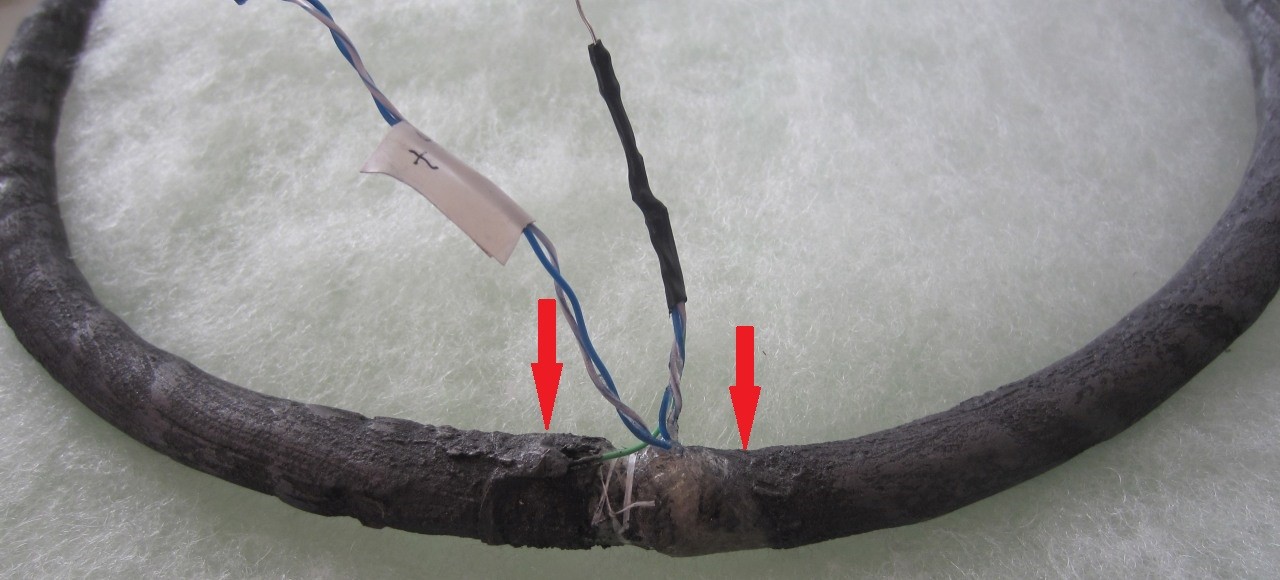

Is 1K ohm graphite shield too low?
  • Is 1K ohm graphite shield too low?
    Tested from end to end at the red arrows, 1K ohm.
    First layer was 22k after curing for 4 hrs, so I added a 2nd layer, now after 24hrs its dropped from 1K8 to 1K.
    Just wondering if this is too low before I put on the final fiberglass outer covering.
    I was using Sherwood interior polyurethane wood varnish with graphite powder in a 1:1 ratio by volume.

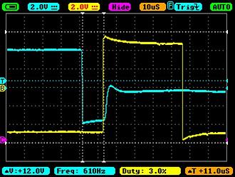

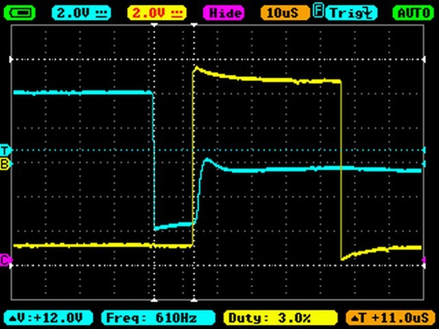

    Its the fastest coil Ive made so far, so I'd like to address any issues at this stage instead of tossing it and starting again.
    22T twisted CAT 5E (0.5mm) stranded pair, 2.54 ohms with a 1.5 current limit resistor in series(under the heatshrink) and 354µH.

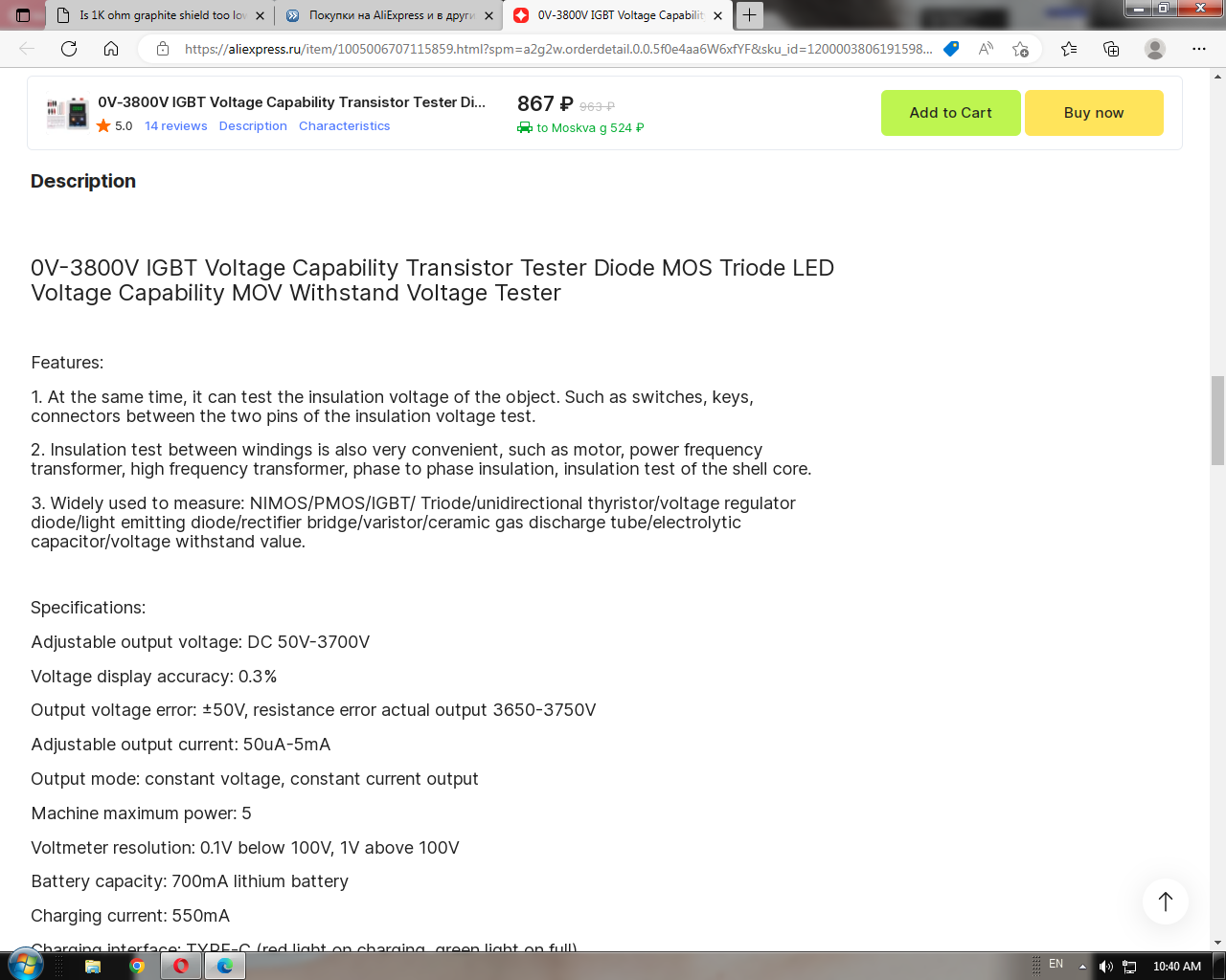

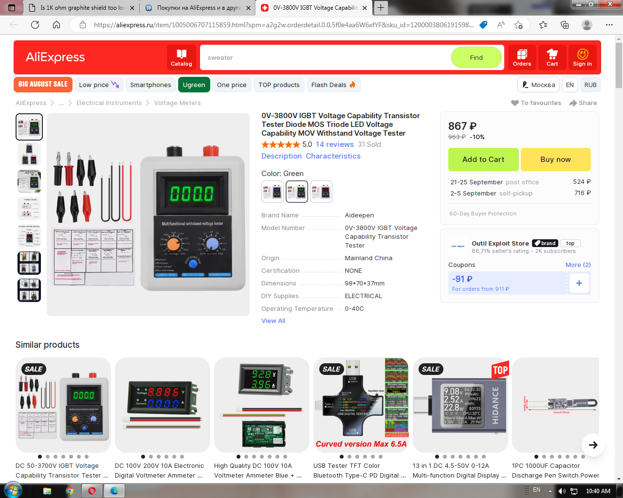

    you measure STANDART OHMS BY ORDINARY TESTER. great delusion. you must use HIGH VOLTAGE GIGAOHM METER that used especial high voltage converter,
    values of its power supply is 1000V....5000V....10 000V.
    DO YOU SEE THE DIFFERENCE?
    we say not about Ohms here, about discharge electrostatic field charging capacity.
    sorry, but your measuring has not deep sense.

          After some time on Google, I came across Woody's recommendation for shielding resistance based on his mods to Minelab detectors.
          The shielding can be measured with an ohm meter, just check the resistance of the shielding over 25mm to be between 40 ohms and 200 ohms, some coils can be higher, some lower, it is not too critical.
          Make sure the shielding is connected to the outer conductive braid of the cable.
          The most obvious sign of a bad coil is if you get a signal from wet grass or green vegetation, this indicates a break down of the shielding inside the coil, but it can also indicate that the lead to the detector coil has some broken strands in the outer shielding. The breakage is caused by overly…
          Mine is around 78 in some places and 160 in others and overall average of 98 ohms from end to end, so I called it done and added the final outer fiberglass wrap.
