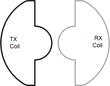

    6- How on earth is the Garrett ATX coil called a DD coil on their website? I think the same is with the TDI original coil. (See attached image)

    6 - This is what the windings look like:
