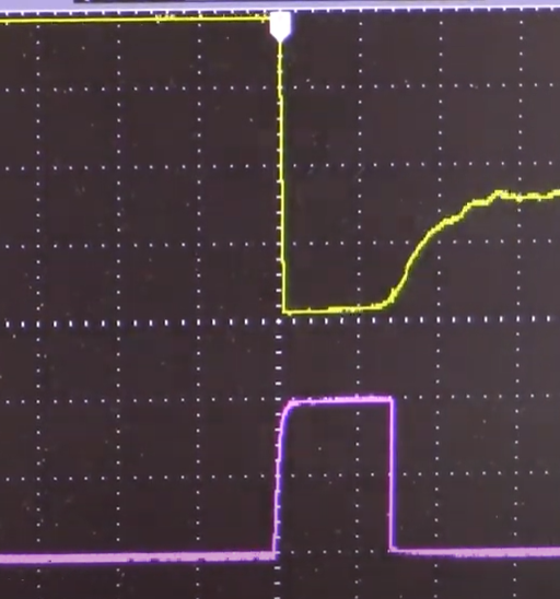

            I have, no issue. Try adjusting the damping resistor value such that the waveform you get has an immediate “ bump” that rises up to nominal level. Normally you try to minimize this but letting it come up really improved the coil sensitivity. I did this on my dual field, pi pro, and surf pi. The detector runs differently, the gain can be raised.Hard to describe.

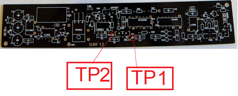

                    You can only get the ideal Rdamp with an oscilloscope and a variable resistor jig connected to R6 position next to the mosfet.
                    Surf Detector describes the jig in his video https://www.youtube.com/watch?v=CrJ5tFFmWyo

                      I connect the oscilloscope to TP1 and TP2, right? channel 1 and two.
                      I am new to the oscilloscope, I have seen and translated those videos and I am learning but there are things I don't know, sorry for my ignorance.
                      Is that how I say?
                      And will the two waves appear on the screen?
                      with resistance of
                      damping, do you move the position wave on the x-axis, so to speak?​

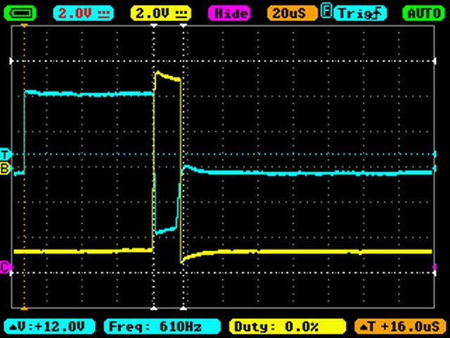

                          No, you change the width of the pulse at TP2, short width= faster which is what you want to detect faster decaying metals like gold.
                          The 2 pulses appear on screen yes.
                          You typically want the delay pulse to end just as the coil output pulse starts rising, because thats when your sample pulse starts listening.

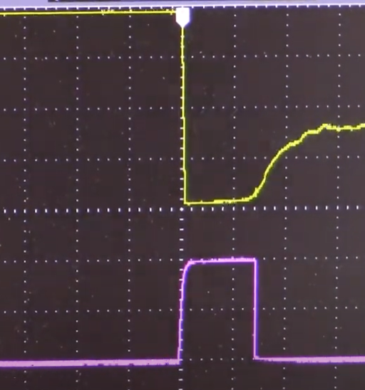

                          Here is min delay pulse using the delay pot
                          Click image for larger version  Name:	pulse delay min.jpg Views:	0 Size:	77.1 KB ID:	428863
                          Here is max delay pulse using the delay pot
                          Click image for larger version  Name:	pulse delay max.jpg Views:	0 Size:	78.1 KB ID:	428864
                          here is the main sample "listen" pulse taken off pin 13 of U7 the CD4066.
                          As you can see it begins where the delay pulse ends.
                          Click image for larger version  Name:	cat5E 354uH.jpg Views:	0 Size:	78.2 KB ID:	428865
                          Basically, once I have the delay pot set to where I like it, I mark the position on the dial face with the coil dia or µH value if I have more than 1 of the same dia.
