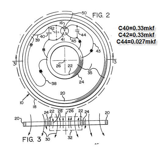

              For few days i will start with constructing,,I'l hope that i will be successful,,,on the original coil with diameter of 162mm are some capacitators U can see them ot the photo under text,,,is it possible to use same cap.. for coil of 320mm diameter?
                formulahhhhhhhh!!!!!
                How about this?
                I am using it from time to time...
                  If the inductance of the 320mm diameter coils is the same as the 162mm, then the answer is yes.
                  However, there seems to be something inconsistent about the values you have given. The resonant frequency for the receive coil (using L3 and C44) is 5.97KHz, but the TX frequency is either 3.36KHz (with C40 only) or 2.37KHz (with both C40 and C42).
                  Are you sure that the inductance values are correct?
                  The other possibility is that there are some additional capacitors on the control board. This is quite likely to be the case if the transmitter is a Colpitts type oscillator.

                      Abouth the capacitors: That values is on the schematic of coil ,,I dont know is that ok,,but i will find soon
