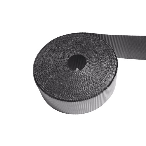

    Does anyone measure resistance for this graphite tape? Can it use for coil shielding?
    for example
    Click image for larger version  Name:	Graphite-Tape.jpg Views:	0 Size:	36.3 KB ID:	429468

      I don't know the actual use of the material, but since it's graphite I'm curious about its resistance if it can be wrapped around a coil for shielding

        There is also the non corrugated tape with adhesive backing of various widths and thicknesses. It could be ideal for wrap shielding coils. Maybe you can ask for some sample pieces of various thicknesses to be sent out to you. Then you can measure and carry out some experiments.
        Or request some more technical details on the graphite composition.

          Thanks.. I was hoping instant info on this if any of member have experience with this kind. I guess I just have to order one first anyway
            This one looks good. If I read the specs correctly? 25mm×25mm = 9.5 ohms?
            Electrically conductive, non-porous carbon tapes suitable for SEM or EDX applications.
              I think its not graphite it is carbon conductive which differs from graphite, like it said 9.5 ohm very impressive, thanks for the links!
                Graphite is a crystalline form of carbon. So it could be semantics?
                I looked around some more. This tape is used to hold samples for scanning electron microscopes SEM. I want to buy a roll to test. If you Search "SEM conductive tape" it results in more hits.

                  Most important is hopefully this thin material whether its carbon or graphite give best result for shield without sacrifices depth detection (which driving me nuts ). I saw Nokta shield on their VLF coil it was dark black, whilst ML coil shield colored grey like. This tape will surely reduce time for coil making.
                    I have used three different brands of shielding paint. Acheson, Y-shield and Stewmac .Acheson and Y-shield are water based and dry with a gray color like pencil lead. The Stewmac guitar shielding drys dark black. They all work well.
                    The tape would reduce time for sure. I have used the metal based tapes like the 3M copper mesh suggested by BBsailer and another tape by Eric Foster. They work but are detected as metal and distort the early signal.
