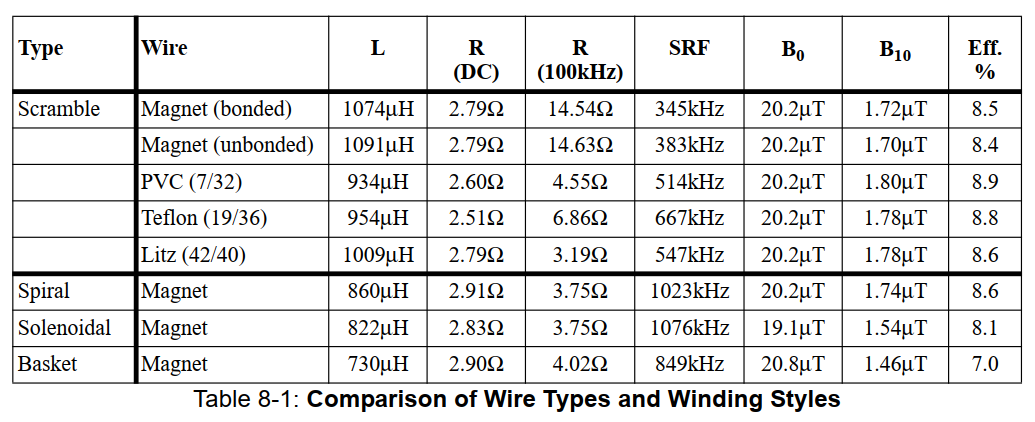

    G'day everyone, i'm just after some knowledge regarding Cylinder coils, on a detecting forum there was a fellow i believe he goes by the name "Chet" and he has experimented a little with building his own coils, he mentioned that the Cylinder style coil has the greatest depth out of any design, (that is i believe a vertical flatwound coil which will make the housing much thicker), if it's true that this design is deeper why don't we see these coils anywhere?, there must be tradeoff's i assume with the design explaining why they aren't common?

        Attached is picture with 3 variants of a mono coil. Double height haves only cylindrical coil in comparison with standard mono. For which option you thing?
          Flat coil in vertical position will have more more height in comparison with standard mono coil

            All coils are deff = 10" (25cm) and 40 turns which gives ~1mH for a scramble-wound coil. B0 is the field strength at the center of the coil, B10 is the field strength 10" away. The solenoidal coil (what I assume you are asking about) has the 2nd worst field strength performance, but the lowest parasitic capacitance. This only looks at the TX side but the RX side will be similar. I was actually a bit surprised by how poorly the solenoidal coil performed, I assumed it would be about as good and possibly better than a scramble-wound coil. But apparently the physical height of the coil reduces the effectiveness of the "highest" windings. I think I ran this in FEMM and saw the same thing.

                I have a DER-EE DE-5000 LCR meter which can measure at 100Hz, 1k, 10k, and 100k. The 100kHz really shows the skin effect.

                    Thanks, you can see the SRF increases with the lower R 100kHz

                        All wire is 24AWG. I used an AC drive of 100mA pp @ 10kHz.
