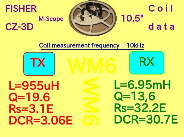

              WM6 once posted this:

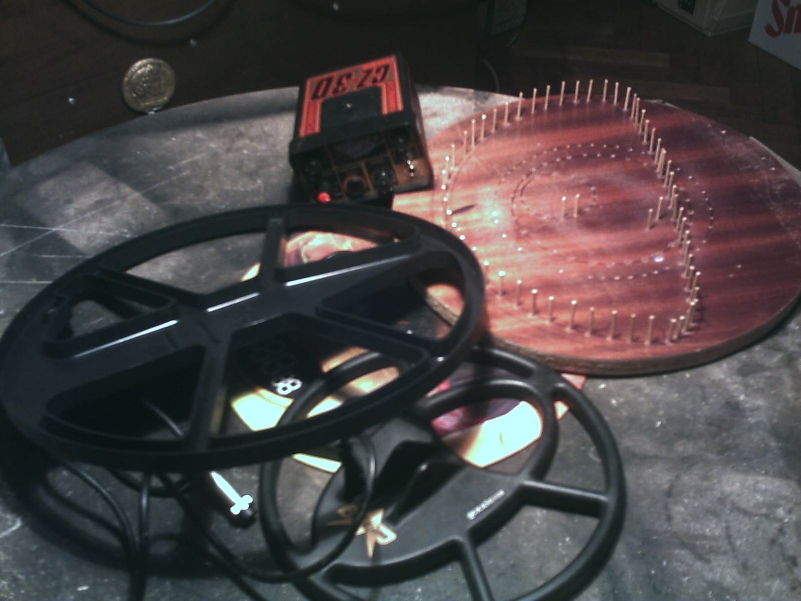

                In 2011, I had a request from a customer to make a larger coil for the CZ3D.
                I think I posted the details here on the forum around that time.
                I'm currently searching the disc archives but can't find anything written anywhere except for a couple of photos.
                Someone with more nerve might find my forum posts about it.
                I remember winding the coil with regular Cu wire and following similar specs as above on the WM6 screenshot.
                It was unexpectedly easy to make and balance that coil well. CZ3D handled it very well.

                  Good evening friends, thank you for your answers, I have been testing some coils and the Goldenmask 9" coil works quite well, in the air it gives me a 1 euro coin at 40cm, the ground potentiometer on dial number 5 approx. and the La discrimination has not been deviated, a gold earring sounds good and an iron earring bad. I will try it in the field but it seems that it will go well.
                    GM coils are indeed having close specs!
                    Never occured to me to think that way!
                    Cheers!
                      Hello again, I forgot to say that not all of them work, it only works well with the 9" the Fighter 13x11 model changes and no longer works the same. I would have to adjust the machine to the coil.
                      Pirate Apolonia coils also work but are not as sensitive to gold.
                      The coils on a Muskeeter Advantage also work.There are variations in behavior.
                      Thank you very much friends.
