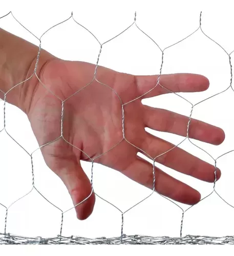

    I live in an EMI infested area, lots of wi-fi networks and some powerlines (low voltage: 220v).
    I was thinking about making a faraday cage to test my built coils.
    Has someone did something similar?
    I'm thinking using a screen like that in the image, or should I use one with smaller holes? Also, should I connect the cage to ground?

    I have never done anything similar. But I would definitely try aluminum foil first and see before I buy anything expensive. Who knows, it might just save the day. I'm not sure how big you want to go with the cage, but I would start with a mid-size box or even a large one like dishwasher or fridge kind of large. I do not know anything about the screen in the image, but I assume you made sure it's a non-ferrous metal and meant for your kind of project. Grounding any Faraday Cage is not a bad idea (in general) safety wise, it's not necessary though but you've got to ask the obvious question: what if the cage itself is going to be detected by the MD coil?

                aluminum foil for cooking purposes – https://drebolii.com/aluminevo-folio . it is cheap . the mesh must have holes smaller than the wavelength – for 60 GHz -0.5 cm ( 5G )
                  I agree with Riss : no holes, or small holes, as the freqs you are trying to block will certainly be up to 2.4Ghz. And if you use sheet material, like kitchen aluminium foil, you will need to solder any overlaps pretty thoroughly, a solder join every 2cm or closer.

                      That's why I suggested.a metal. insect screen,, with meshes around 2mm...
                      Sure. a really good move is also.as Carl suggests..you can use double shielding..for even more thorough elimination of Emi...​
