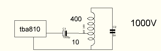

        This patent uses a non-symmetrical tap to create a high voltage tx. Years ago based on this patent I was able to create a 130v tx signal, It was impossible to null the rx coil. Maybe using some feedack between the TX--RX would help? In the patent he states using super hetrodyne method to demodulate the Rx.

          This patent uses a non-symmetrical tap to create a high voltage tx. Years ago based on this patent I was able to create a 130v tx signal, It was impossible to null the rx coil. Maybe using some feedack between the TX--RX would help? In the patent he states using super hetrodyne method to demodulate Rx.
          This patent schematic is actually helping me understand the principle behind this. Looks like the "smaller" winding energizes the bigger one that is itself resonated with its own capacitor. Thank you! I could try and build one like this just to try it

            No need to wind two coils at the same time. For a center tapped coil for instance, wind 30 turns and stop make a a short loop away from the main bundle. Bring the wire back to where you stopped and wind 30 turns more. Now you have a 60 turn coil with a center tap at 30 turns. The patent will be the same but you might wind like 10 turns, make loop(tap) and wind 50 turns on top.. This would be a 60 turn coil with a tap at 10 turns
              Click image for larger version  Name:	image.png Views:	0 Size:	5.9 KB ID:	433997
              wire 0.6 mm​, 8kHz coil diameter 22 cm.

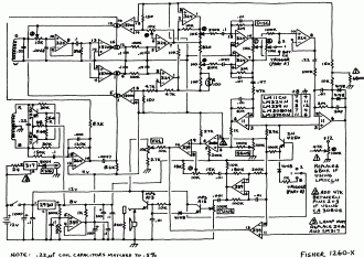

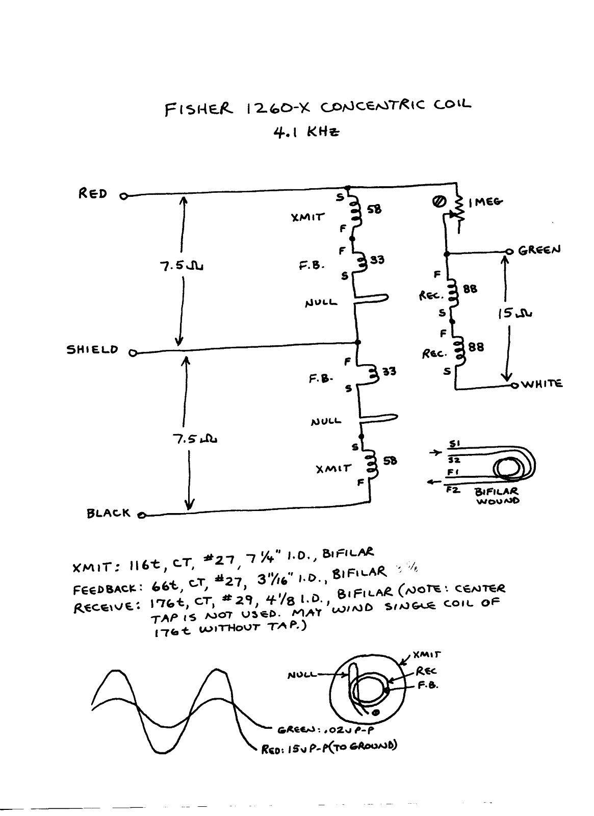

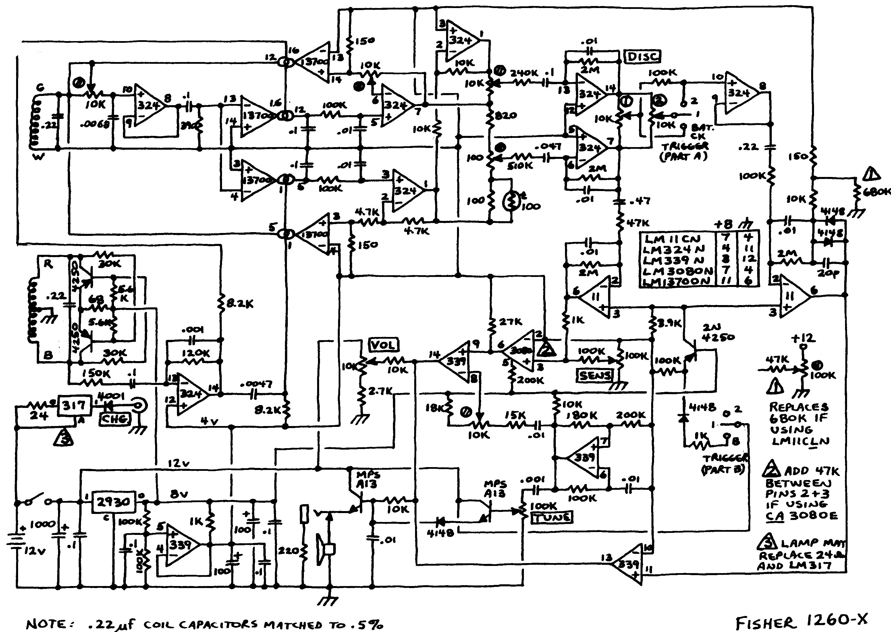

                The fisher 1260x used such a coil,(as well as Nautilus and Aquasound. Don't be confused with all those windings, they are just the feedback coils for a concentric coplanar IB coil arrangement
                You could wind a DD coil type with just bifilar and centre tap ( no feedback windings required for cancellation). Drive it with a circuit similar to 1260x TX circuit
                Click image for larger version  Name:	Fisher_1260X.gif Views:	0 Size:	146.8 KB ID:	434017
                Click image for larger version  Name:	Fisher_1260_Loop.gif Views:	0 Size:	88.7 KB ID:	434018

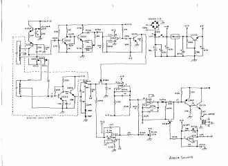

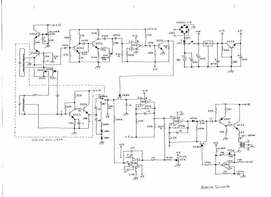

                  aquasound schematic depicts a slightly different arrangement, this might be more akin to the "autotransformer" description. I suspect such a coil would have to be wound with four wire "quad-filar" and the start/finish of each wire connected in the appropriate manner as per the schematic of the coil. No feeback windings would be required as there is a feedback system with potentiometers to achieve induction balance. That would be my guess.
                  Click image for larger version  Name:	Aquasound Schematic.jpg Views:	0 Size:	95.8 KB ID:	434021
                    The coil part of the aqua sound schematic is incorrect also the 2n2222 driving the coil should be a 2n2907. See the Nautilus 2B schematic

                        This is poor advice. Winding bifilar is the easiest way to wind such a coil, not a "harder way" , and it guarantees identical performance for each half of the wind, with the centre-tap truly central.
                        If the OP was wanting a higher step-up ratio, he could wind the TX tri-filar ( three wires at once ) to obtain a 3:1 step-up voltage ratio.
                        Edit: it would actually be better to wind this quadri-filar, and then parallel-up two of the windings to make the driven winding.
