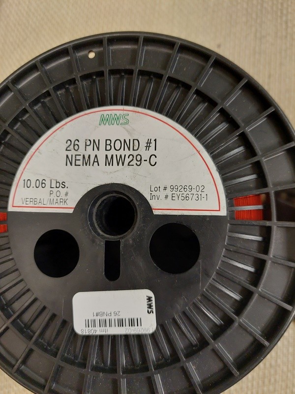

Using the Rx mandrel dia 4.5", we start by winding the feedback coils. I use alcohol bondable magnet wire. The fb coils use #32 awg. Start at 3 o'clock wind 8 turns stop at 12 o'clock we now have 8.25 turns, make a loop of wire for the ct, wrap another 8.25 turns, stop when the 9 o'clock mandrel slot is facing up. Start and finish should have about 3 inches of excess wire. The CT is twisted and tinned to about 1" in length. Now wrap the Rx coil on top of the Fb windings. Start at 12 o'clock wind 168 turns of #32 pnbond finish at 12 o'clock. The Tx coil is made with #26 pnbond. The Tx mandrel is 9.375" in diameter. Start at 12 o'clock, wind 33 turns stop at 6 o'clock make a CT loop, wind another 33 turns stop at 12 o'clock. Remove from mandrel and unwind a 1/4 turn from the start and finish before the bond hardens. Let the both coils dry for 24 hours. More later
