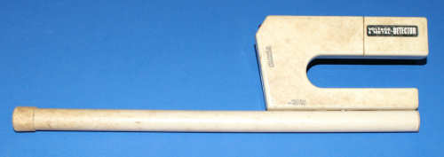

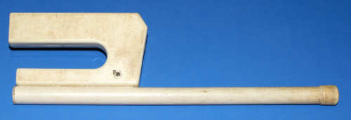

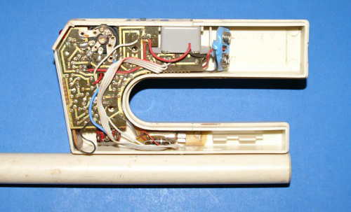

            Here ya go...
              Thanks Carl,
              Is the vib motor you added the little grey box in the last picture? Any details like the part # on the motor you used?
              Also, is that unit an older version of the GPD-902 made by GB Electrical, that this page (http://www.tomstreasures.com/probe.html) uses for a homemade pinpointer?
              Do you still use this as your pinpointer, and are you happy with the performance?
                Looks like the same GB unit. I think I bought it for $4 or $5 from a mail-order surplus house, most likely All-Electronics. The grey box is the buzzer, the vibe motor is the cylindrical shiny part in the bottom center. I can switch between vibe and buzzer, but always use vibration because it's more sensitive. Have no idea which vibe motor I got, it was also from the surplus house.
                Yes, I use this exclusively. I've tried others, but most cannot match the performance of mine.
                - Carl
