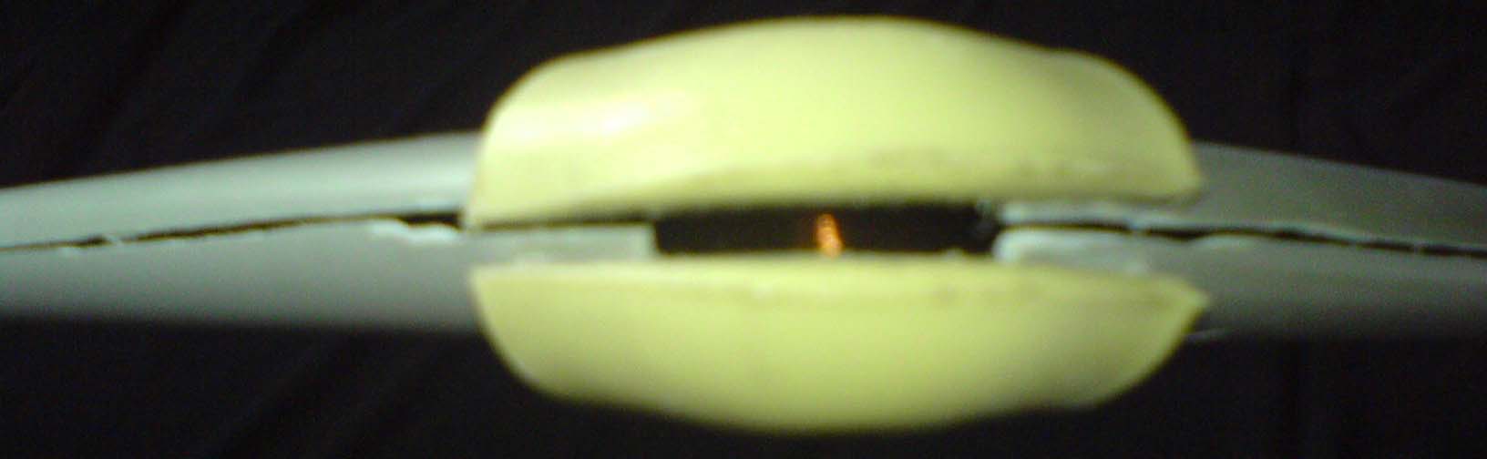

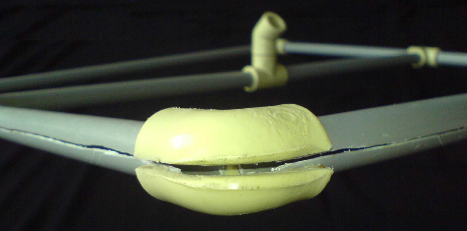

      My square coil
      Hi Carl,
      I made a gap along the PVC frame then I did wind the wires between the gap.
      Its detection is very poor with any PI machine.
      Does my winding have problem?

        What Dimensions is it?
        How many Turns?
        What gauge of Wire?
          How many Turns?
          What gauge of Wire?
          70cm x 70cm
          12turns
          0.4mm wire
            70cm x 70cm
            12turns
            0.4mm wire
            That .4 mm appears to be a 26 AWG Wire.
            I would try a larger wire, about a 20 AWG (.8 mm) and maybe a few more turns. (Possibly 15)

                    As "Bbsailor" Said: You Can just Join to it IF you just want to Add a Few Turns, But I still feel your wire size is Too Small.
                    Using that .4mm wire results in a fairly high resistance, thus reducing the pulse current and depth of detection.
                    What are you trying to find with this Square coil?
                    Hopefully only Large Objects. These large square coils do not detect Small objects very good.
                    I would still recommend you totally Re-Wind it with a .7mm or .8mm wire.
