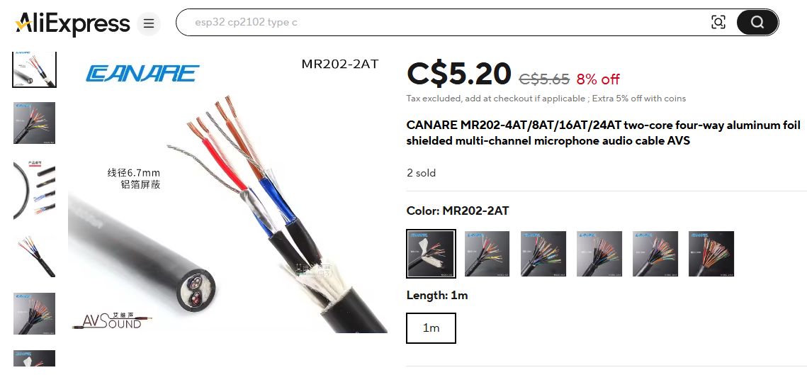

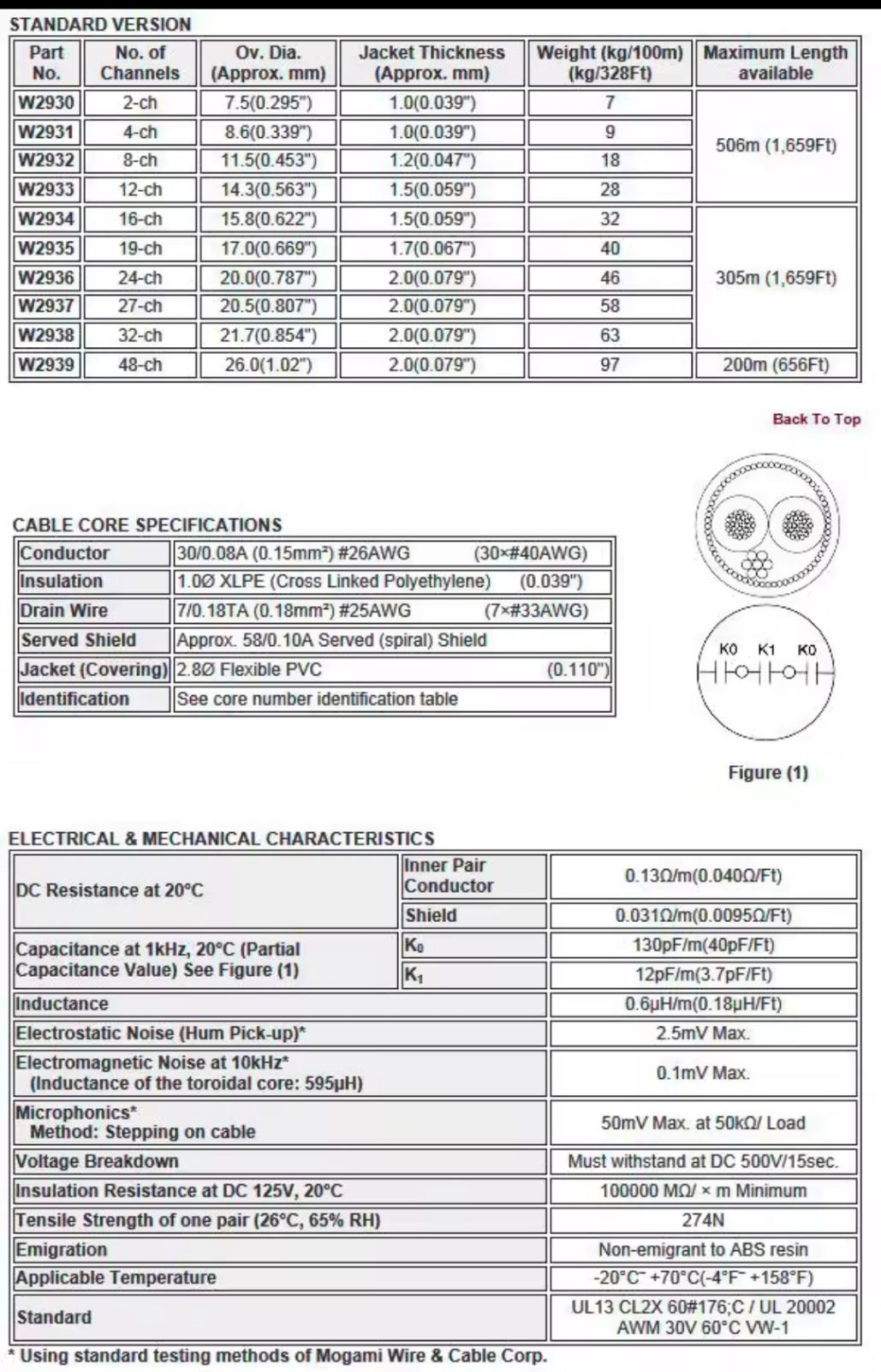

    Hello guys. I have a metal detector on which I constructed a new sensor head, an induction balance. I haven't set her up yet. My question is, can I use this cable. W2930.

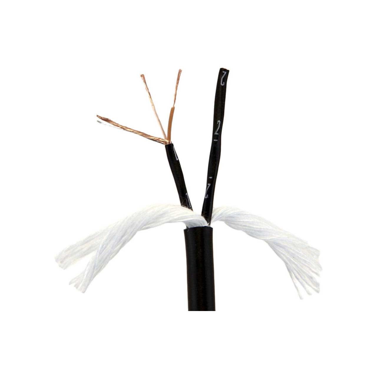

              Honestly, it's hard to understand the exact construction of this cable from the pics & drawings. But it appears to be dual coax, similar to S-video. It should work for an IB coil.

                The cable on the picture and on the drawing are different, on picture I see on the left - 2 wires with shield, on right not striped wire , I believed it is the same inside construction 2 wire and shield.
                You ask the question the seller.
                If it is wat I thhink that cable is expencive but perfect​

                  Less expensive and no doubt what you get.
                  https://www.aliexpress.com/item/1005002693306576.html?​

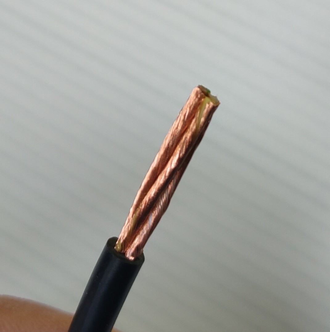

                    Thanks for the answer, but I don't want it with an aluminum shield. How long will it last before it starts making noise?

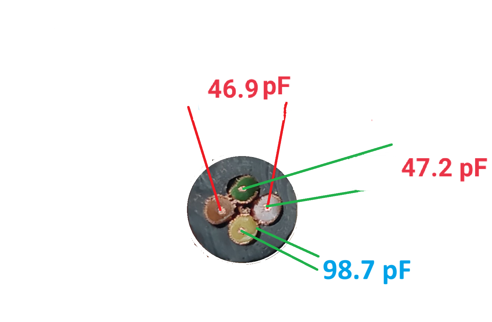

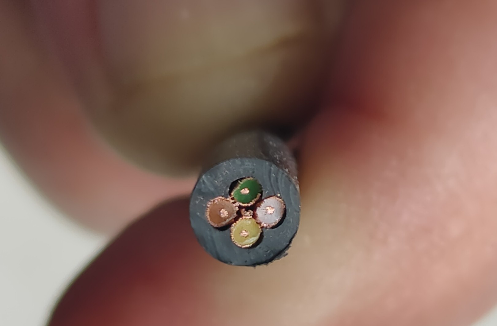

                      I currently have the one in the picture. Brown and white on the transmitter and yellow, green on the receiver. Not sure if it's good for IB yet.
                        Please avoid wires with aluminum screen.
                          The cable is copper shielded. Here are the capacitances. It seems to work well. I'm already testing it, but when I'm done it will be clear.
