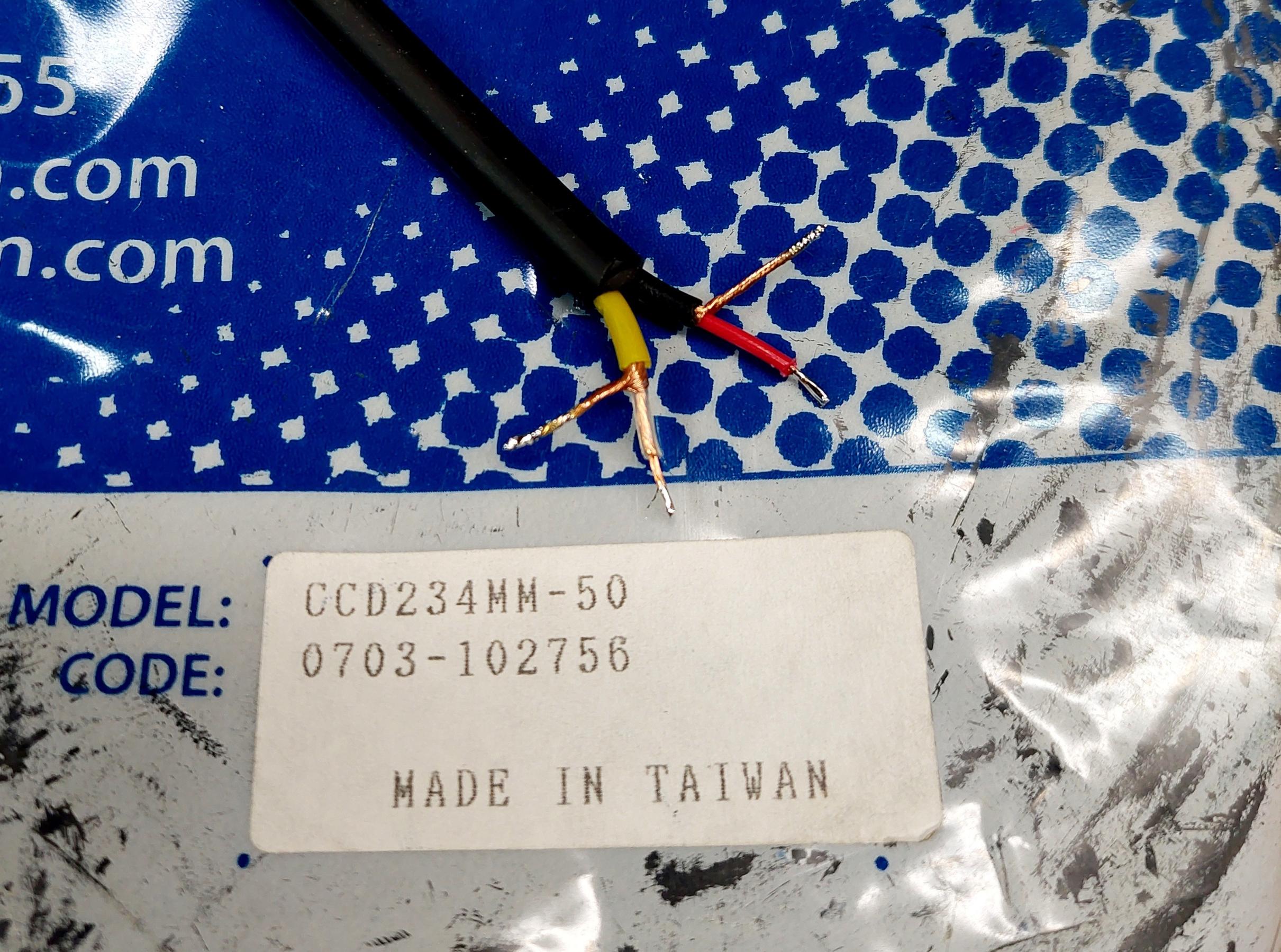

    Anyone looking for coil cable might be interested. I found this all purpose cable that works well on VLF and PI IB coils. It is very flexable, have used it for a number of years without problems. It is dual coax s-video cable made by L-COM. Unfortunately s-video has become obsolete, so these cables are becoming harder to find. I bought some 50 foot (15,4m) cables on ebay for $20. You can make 8 to 12 coils with this length. Be careful with Chinese wire and cable, some is tin/copper plated steel!

    L-COM CCD234MM-50

    There is no inner braid to shield the cables and separate them from each other. Especially with VLF technology, this allows interference to pass from TX to RX.​
      It is dual "COAX" cable and each is fully shielded. In the photo I twisted and tinned the shields..
