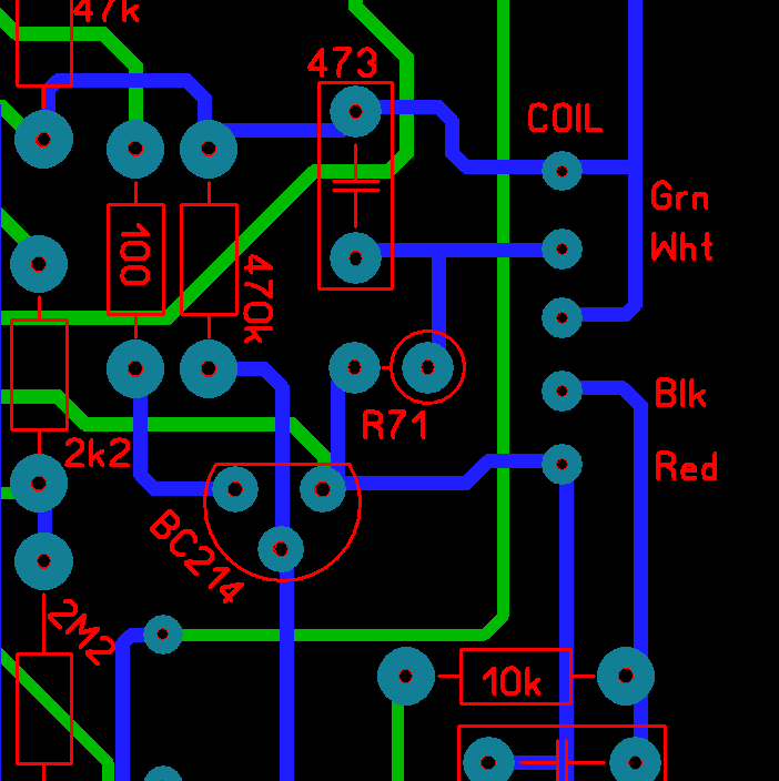

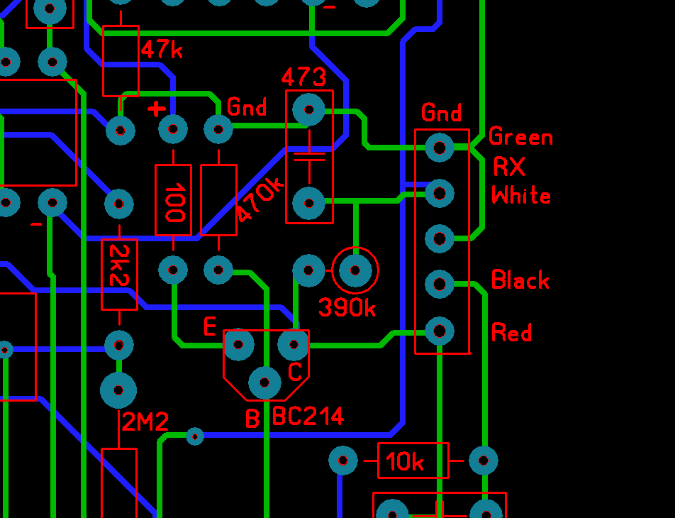

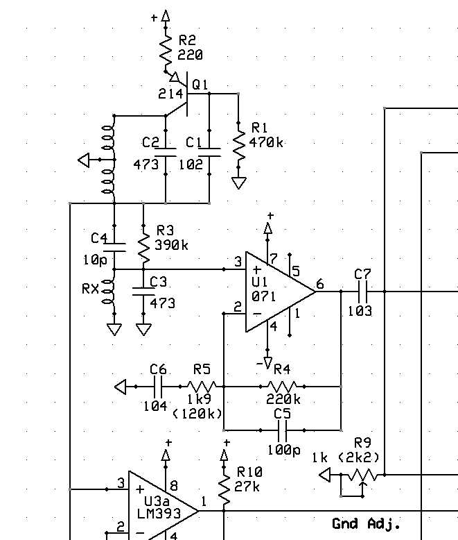

    I'm looking for the connections (and origins Tx 0, Tx 1, Tx GND, Rx Input, Rx Gnd) on a Cscope coil connector for CS2MX (old version - 12kHz)
    Does anyone have this?

          this is tesoro clone for me. so open folder TESORO and look specs on coils.
            Ok, thanks Ivconic, kt315.
