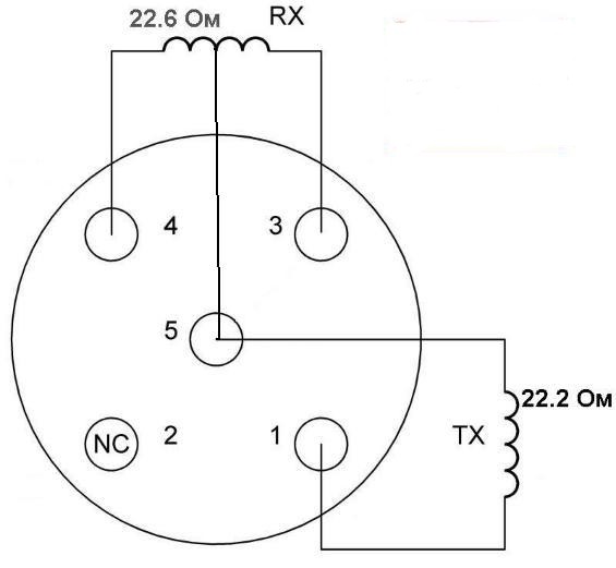

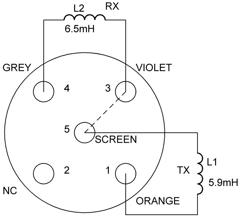

    Does anyone have a pic of tesoro 5 pin coil connector pinout it would be greatly appreciated
    The correct values are: 5.7mH for TX and 6.2mH for RX.
