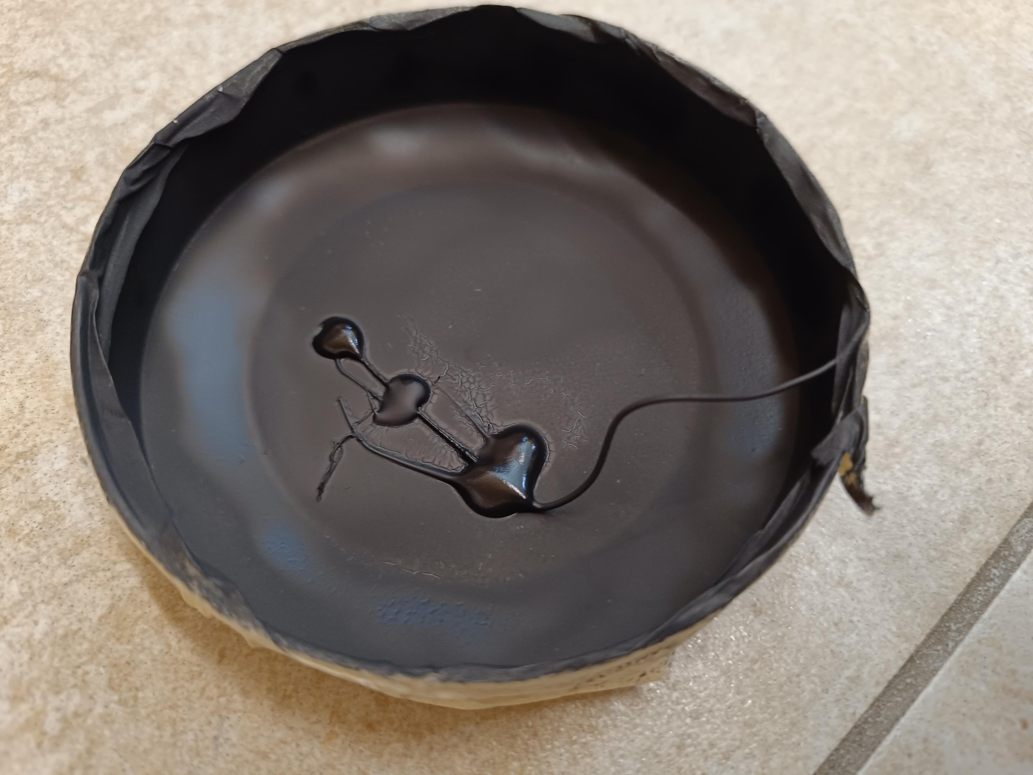

    "Good morning!
    Can you help me on how Is the best way to use AR838 conductive paint?
    How many coats should I apply? Should the paint be abundant or is a thin layer enough?
    I need to shield a coil for an IB VLF.
    I wait fora kind reply. ​
    Apply 3-4 thin layers of paint. If you apply 1 heavy coat the paint is likely to crack and craze which will make the shield less effective.
      Thank you for responding,
      does conductive paint need to be polished once dry?
        No
