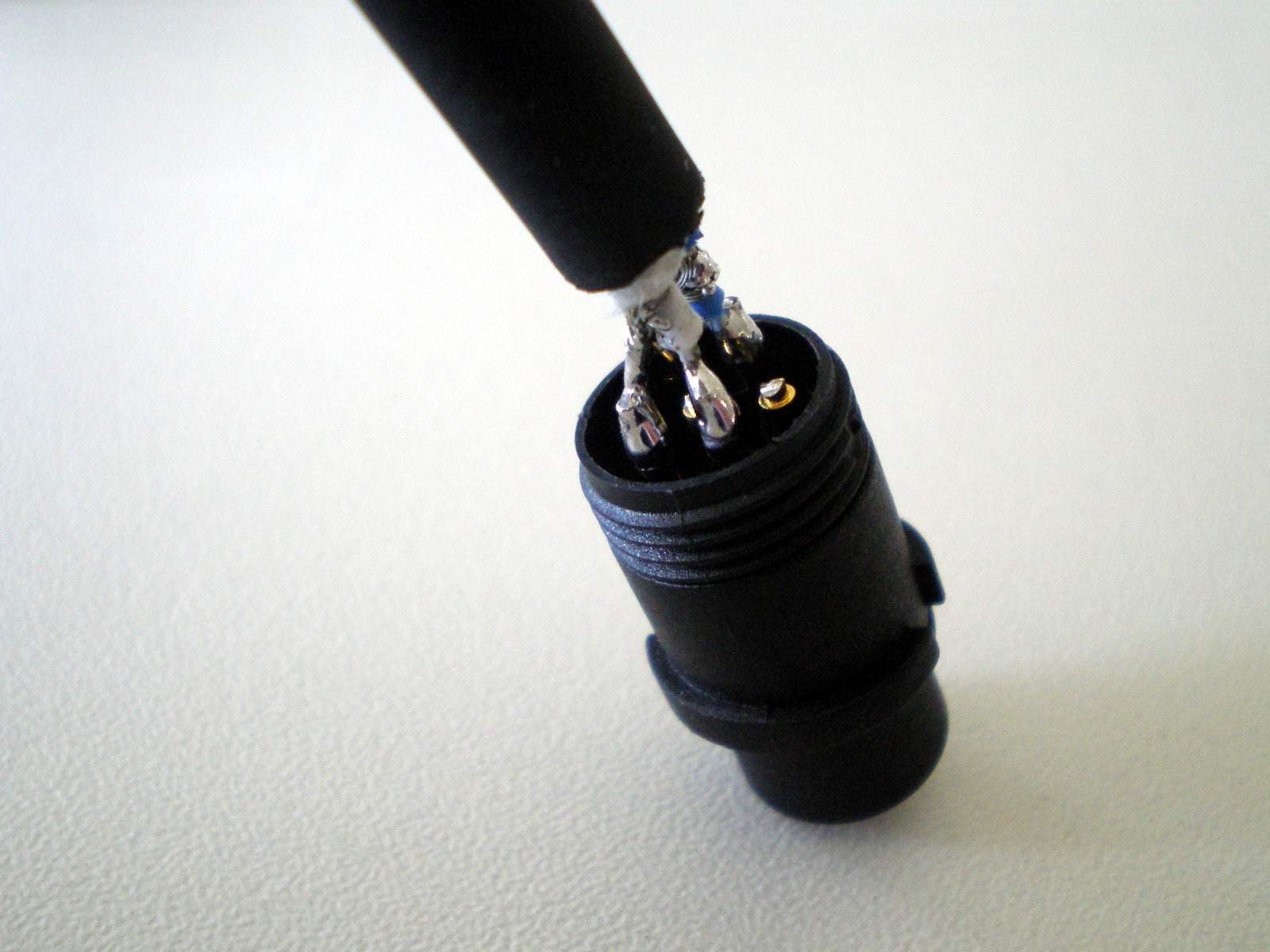

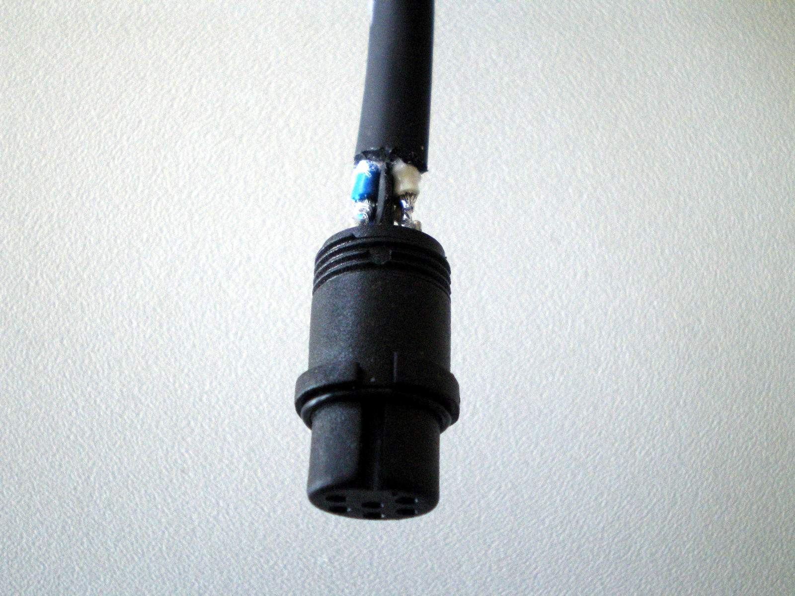

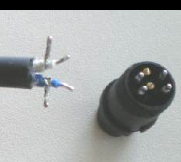

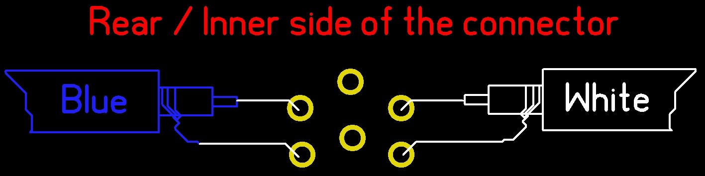

    Does anyone know how the XP GMP coil is connected to the plug? Could you please post a picture or schematic.
    Click image for larger version  Name:	7.jpg Views:	0 Size:	456.7 KB ID:	445055Click image for larger version  Name:	6.jpg Views:	0 Size:	205.5 KB ID:	445056Click image for larger version
        Thank you very much. I have a problem because, as I can see, the coil is connected correctly, but the detector has very poor sensitivity. The socket was replaced because the cable was broken.
          The reason for low sensitivity can be different.
          More things are possible.
          The most trivial thing is to check the potentiometers.
          They often spoil from moisture.
          Then check if the wires from the coil connector are well connected to the PCB.
          I can guess everything else academically, because we don't have a schematic.
