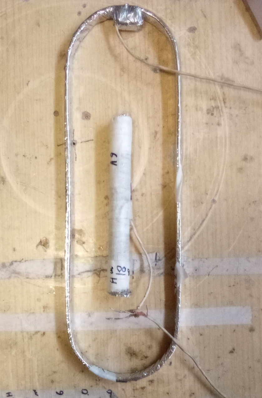

    Ai may reinvent the wheel.

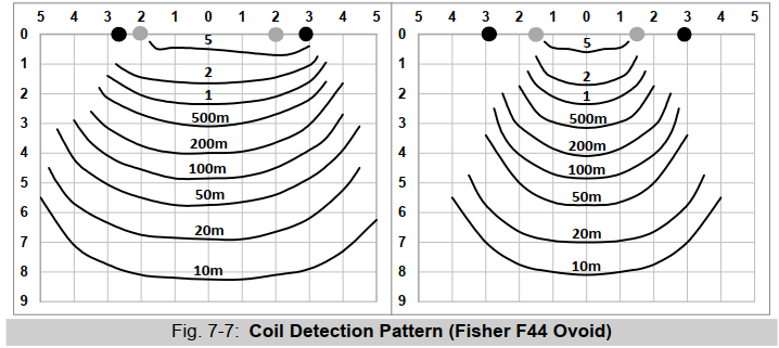

            Woody, have you built and tested this coil? It seems like the orthogonal coil should give a double response on targets. I would like to see a response map similar to this:

                Yup, a null right in the middle. Interesting.
                  It’s a line null, not a zone null, be like a Super D but I have a cure for that.

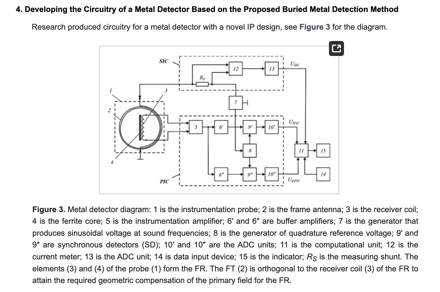

                        The orthogonal sensor is patented several times over during recent history ...
                        for example :
                        The russians have done alot of work on them .. including a verison that has a "cartwheel" spoked sensor ( PI and VLF )

                          Click image for larger version  Name:	image.png Views:	0 Size:	1.20 MB ID:	446762
                          The problem with this kind of sensor it is reacting to human body, it is like poor shielding, but I am using the same shielding method in DD sensors where is no such problem.​
