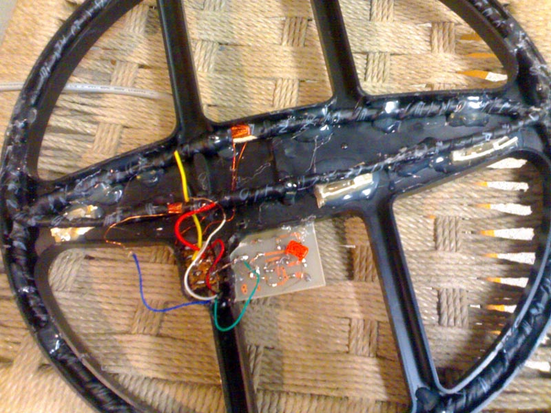

Hi All. As i wrote 10 days ago i had problem with the shielding at my DD coil (i had use foil). As Reg told me i made a new coil with semi-conductive tape for shielding. Now the coil do not response. I can't balance the coils
so i have at least a signal of 200mv
at the Rx coil. When i place a metal object near the coil (1...2 cm near) i see at oscilloscope a phase shift but not an increase of the amplitube(width) of signal (maybe shield stop it). I measure the resistance of tape and i find 14Kohm from one side to the other of Rx coil and 34Kohm at the Tx coil. Can anyone (where are you Reg??) tell me which must be the resistance of the tape ??, or what other is wrong ??
