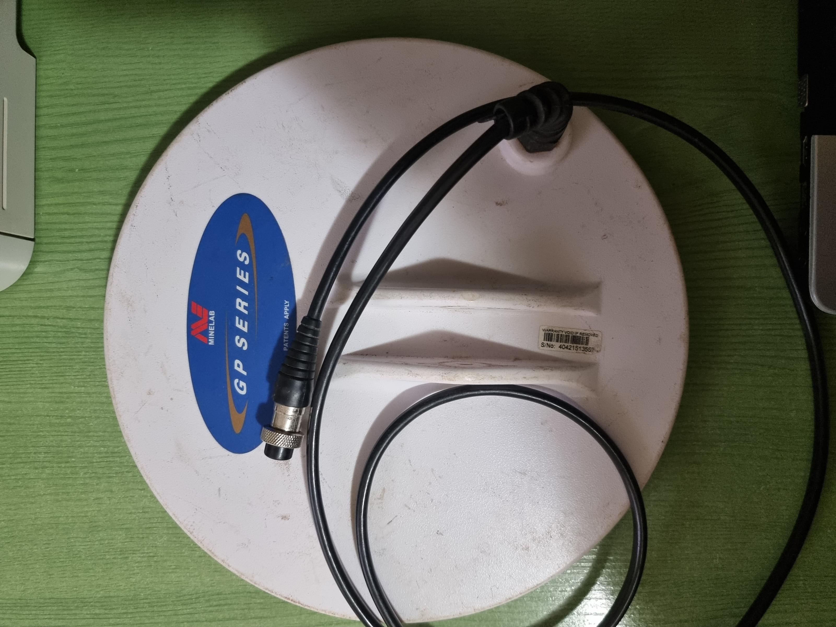

        In case my information is of any use to you; I have an original 11" DD search coil for Minelab GP series and these are the measurements:
        TX = 310 uH = 0.5 Ohms
        RX = 620 uH = 17 Ohms
        Regards, Eduardo.
          Hi Eduardo1979
          is your MineLab coil the model "Commander" (white color round DD-Coil 11 Inch for GP Series)?
            Hi Eduardo1979
