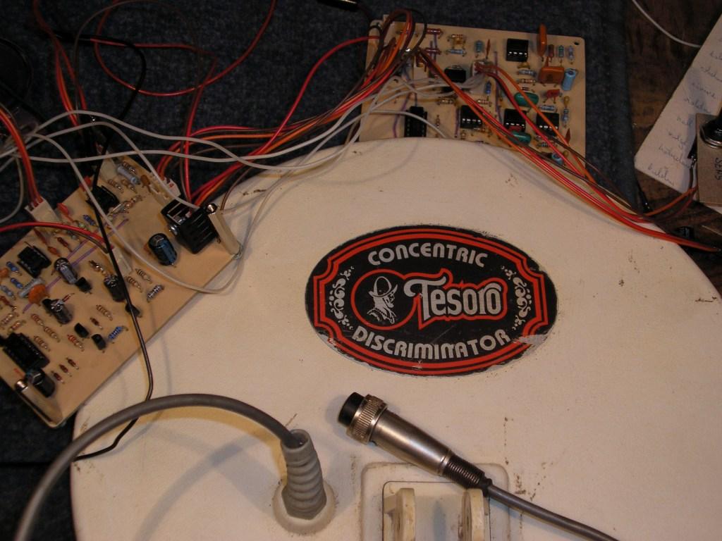

          Hi Max
          I mesaured my coil parameters with MASTECH MS 8201H and get this results:
          TX-23,9 Ohm 6,29mH and RX 22,9Ohm 6,92mH.
          Yes, I think signals on IC5a pin 1 and after R34/C18.I think, that this signals are same with Yours.My IC-s are the same, what writed in shematic, but at that moment I dont know, what is wrong. In discrimination mode sensitivity is 2cm (for Al plate 3cm*3cm) and in All metal mode its generated periodicaly signal, but no metal is near. My TX amplitude is 7V from peak to peak (after increasing R1 to 3K, because my sinus signal was little damaged).
          Ok, I continue to check my PCB.
          Thanks to You

            Hi Satel,
            I think you need to check at pins 5 and 3 of IC8 (lm393). I solved the poor disc problem cutting the 50Hz noise that I can see there, just shielding.
            But what's strange is periodic in all-metal. Seems some feedback signal...have you checked that +V / -V remain stable when it sounds ? sometimes current increase transients are detected as signal by amplifiers if supply is not well regulated and stable.
            Best regards,
            Max
            • #66
              Hi all,
              I think I've solved the problem in a cheapy way. My bandido seems works now.
              What I have from tests in disc mode using a near-to-extrem setting of the disc pot:
              - 1 eur coin at about 30cm
              - 2 eur coin at about 32cm
              - 1 half crown (diameter 32mm) at more than 35cm
              - 1 small gold ring (1.5grams) at 24-25cm
              - 1 copper cilinder thick 0.5mm, diameter 46.5mm, height 12mm at 42cm
              - 1 silver coin (diameter 30mm) at 22cm
              That seems pretty good... and like what I expect from Bandido.
              All tests where made with fast object movements relative to the coil, tring to simulate
              1m/s swings.
              It sound also with iron (and rarely with steel) sometimes...but at few cms and with big masses (tools, hammer...).
              So it's not perfect discrimination in my unit.
              Question: have bandido total disc vs IRON ? I don't know.
              Maybe it depends only of capacitors used.
              Now the solution, I've used:
              - eliminate as much noise as possible
              Noise is really subtle.
              I've done using semi-encapsulation of some part of the circuit board using a thin aluminum
              sheet (insulated with plastic foils) shaped to cover upside of components/pcb. On the copper-side
              I've used another PCB (single side copper downside), not etched, connected to circuit pcb using
              screws and plastic spacers to give 4mm of distance from circuit copper-side.
              Both metallic shields connected with a wire to a unique GND PCB trace.
              This cutted out more than 95% of 50Hz noise...and now I have two symm signals at inputs of
              comparators (IC8a-IC8b).
              This way I get output nearly flat, at a small negative voltage, that rise when an imbalance
              occourrs thus giving the audio signal to show-up.
              I've noticed that bandido circuit is very sensitive to external noise also if one use (like I did)
              fiberglass pcb...using solvents to remove flux after soldering etc...and that's expecially true for
              the disc signal path starting at c20/c21.
              Only thing to solve and avoid big troubles is Faraday shielding sensitive parts.
              So, other good solutions can be using Gary's pcb with a huge upper GND layer and RF guards or use the germany
              group pcb or another that have a good, wide gnd screen.
              I think that Gary's PCB is very good for testing but, if one can do, to have the best he must add a second
              upper layer of copper (double side) to give it a good GND plane and maybe also built in "jumpers".
              Unfortunately, I can't do double or multiple side PCBs at this time... so I'll continue with metallic shields,
              at least for now.
              Other easy solution is insulate everything in a metallic box connected to GND - if a removable cover
              present is easy enough to open and connect probes etc for testing.
              IVCONIC, TRY SHIELDING AND LET ME KNOW.
              Thanks again to all.
              Best regards,
              Max

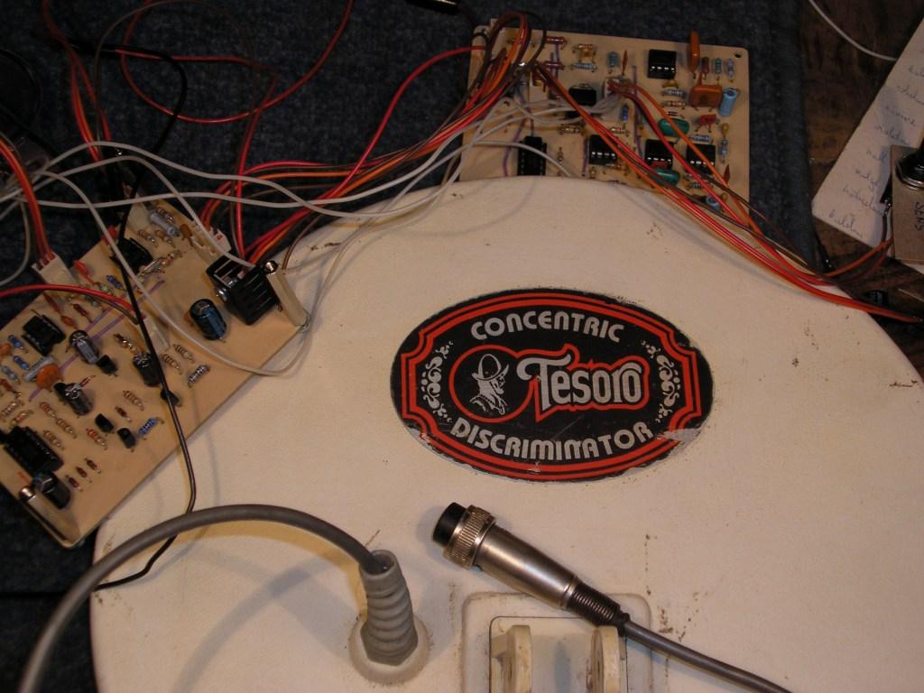

                              Hi Max and other guys
                              I lost my head.I building Tesoro Bandido, I used original coil, but it did´nt work.In pin 7 IC7b (by Carl schematic) is signal with amplitude 0,6V.Looks-like coil not balanced.It is used coil but outside view is OK (not opened).In all metal position (with switch S1, auto-tune connected) it detects 2cm coin at 22cm, but if I open S1, it detects coin only at 2 cm.Can You give please some ideas?
                              Satel
                              • #75
                                Satel
                                Yes I would say your coil is not balance perfectly.
                                Too much un-balance will give a Square wave at that pin.
                                I use Pin 7 of IC7b to get Zero balance on my coils, also using the TX Signal from the bandido.
                                Seeing as IC7 has quite a bit of gain, it Works well this way to get Maximum Cancellation.
                                I also Tune the Recieve using parallel caps to C15 to get Peak Resonance.
                                Gary
