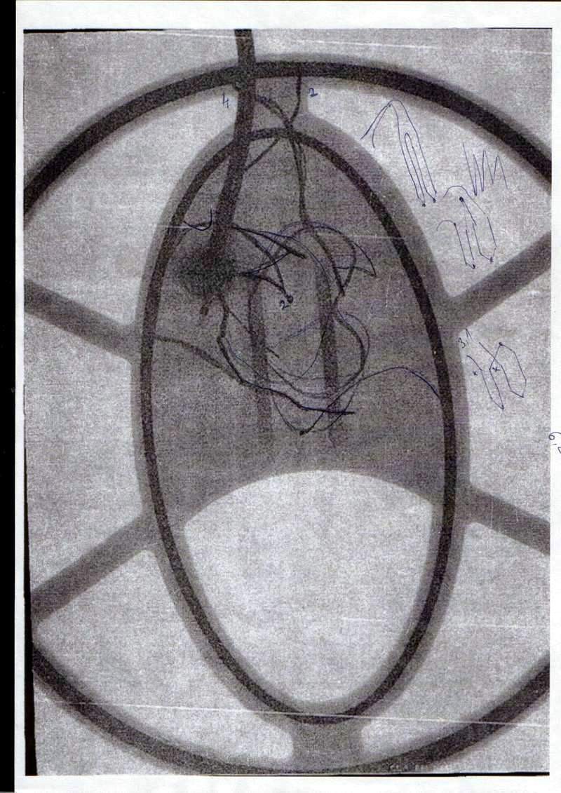

      2nd page of the PDF document, the x-ray image of the coil for CZ is missing.
      I personally took coil x-rays many years ago, I had a friend who was an x-ray technician at a hospital 2 km from my house.
      I even have the original x-ray somewhere in the boxes.
      I posted all that here on the forum a long time ago, but now it's hard to find.
      In the meantime, the forum has undergone many changes and several hacker attacks, which further complicates the search for content that is 15, 20 or more years old.
      Here is an image to supplement the PDF document.
      ​Click image for larger version
Name:	fisher sonda.jpg
        Good job! Alexandre
          ivconic​, thank you for sharing. Your X-ray is now included in Coils Atlas v2.
