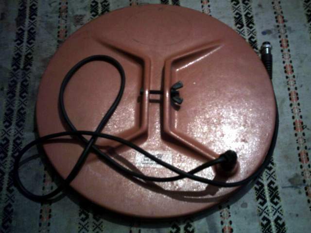

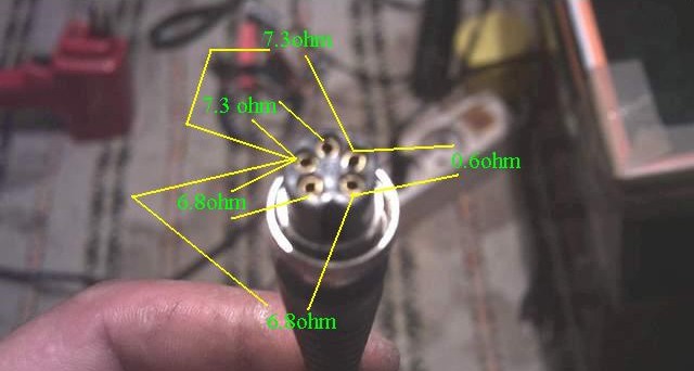

    I have GP 3500 with mono coil...6.3 ohms resistance...nothing else...
    On connector 3 pines wired togather, one separate and one giving those resistance with those 3...? But it is working fine!!!?
    I can prepare photo and wire schematic if you want...if any help?

          i am to tired to shake my brain to get picture of inner wirements...a bit confused too, but here's what i found out;
            ... this is 350mm mono coil...
              Now i see photo is blur, so if you asking about values on right side of photo;
              it is 0.6 Ohms...the rest is visible enough...
              Anyeay if this helps than i'll be glad...
              Regards!
              p.s. this is 350mm coil, bought in Germany...

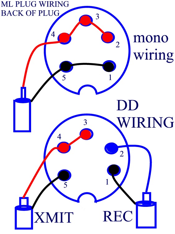

                I suspect your coil is not a mono and is a DD instead. I have attached a simple drawn pic of the coil connector. The numbers are the numbers on the connector and the connections are as you would see looking at the back of the connector.
                Righteous and Ivonic,
                If you look at the pic I attached, you will see several of the connector pins are tied together on the mono. Actually, only 2 and 4 are needed to be tied together on the mono. Although I think the pic is clear, I will note the black connections indicate connections to the shield of the coil coax for that winding. The black lead connects to one leg of the winding (s). I would keep the two coax shieldings separate in the coil wiring on a DD coil until they get to the plug. The red line is the lead for the transmit winding and the blue is the receive wire that goes from the center connector of the coax to the receive coil on the DD.
                The different resistance readings you have on your coil are indicating the receive connectors are connected to a different winding.
                Normally, the coil resistance of a mono coil is 0.8 ohms and the inductance is about 300 uh. On a mono, you shouldn't be reading the different resistances. In other words, you should read 0.8 ohms from pin 1 or 5 to pins 2, 3, or 4 on a mono coil.

                  I guess you have right !!!
                  I was confused from a start when measuring resistances..
                  Earlier i expected double D coil, but was confused with resistances i got!
                  Now i understand this a bit.

                    Ivonic,
                    I think you can try the DD coil as either a DD or as a mono by just flipping a switch on the control box.
                    Now, I wouldn't try doing anything to the coil or the coil connector. Chances are, it might now work correctly after. They are extremely touchy.
                    Instead, I would try using the switch technique. What you should notice is only half of the coil will be active when you do switch to the mono mode. This will tell you which side is which. Also, it would be interesting to know if the Coiltek DD coil will work in the mono mode. Normally, the ML's are very temperamental and require a specific winding resistance to work. Coiltek seems to be using a different transmit resistance on their DD windings.
                    If you do try to use the coil in the mono mode, let us know how it works.

                              Now, you do not need to do anything to the coil to be able to use it on other detectors. You will need to modify the other detector input designs to allow for the use of a DD coil, though. Carl has done this on the newer HH boards.
                              So, once you modify the PI input and install a 5 pin connector like that used on the ML's, you can use the coil on any PI. The Coiltek has a built in damping resistor for the receive winding.
                              On the DD coils, Coiltek does not use a .8 ohm 300 uh transmit. They reduce this resistance down a little, so your reading of 0.6 ohm could be correct. I haven't tried to measure the coil I have apart. The 0.8 ohm resistance is only on the mono coils.

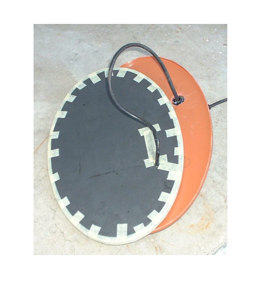

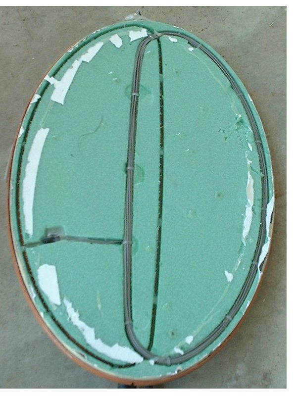

                              PS, I have attached a pic of the inside of a Coiltek DD coil, so you can see the winding arrangement. Normally, the windings are covered with a conductive paper and can't see them. The conductive paper is the shielding. The second pic shows the top of the coil and what it looks like inside the housing. The dark gray surface is the conductive paper.
