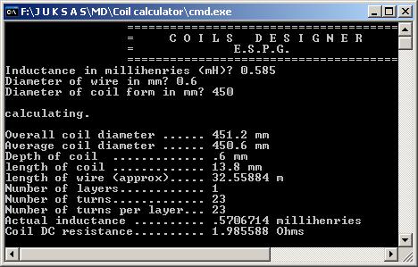

    Same coil used with Pulse Star II....1.9 ohm resistance....thats all what i know....I have it with PS II....
    I think same manufacturer, same model, smae connector...same everything for Lorenz and PSII.....
      Pulse Star II
      Pulse Star II 1x1m coil 1,72om 585µH
      45cm = about 23turns 0,6mm wire
