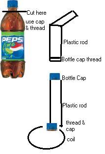

Things needed
A) Cap of plastic Pepsi bottle, inner plastic thread cut from the pepsi bottle or any other plastic tubing or bottle with threads and end cap
B) Plastic tubing from electrical shop used to push in wires into the walls
c) Frisbee for coils or any other plastic household discs...quick glue etc etc
use Innovative Ideas like plastic tootpaste cap or pepsi cap and cut its inner thread end too, seal this end to the coil frame, use the other end and stick it to the plastic rod ie the holder rod of the detetcor,
For easy carrying use these methods
for the rod to be 1.5 meter long use 2 halfs of it ie 1.5meter/2 = 75Cms and stick one end of the rod with a plastic thread and other end with cap and u can join these rods by tightening the thread.
