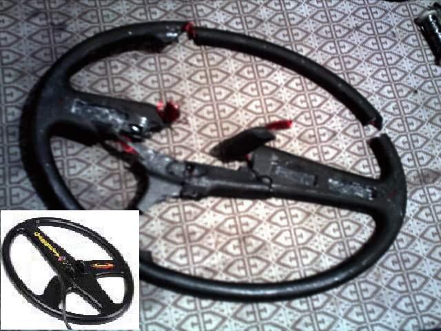

    Here is gift for Garrett enthusiasts;
    I needed large,nice coil housing to make powerfull coil for TGSL.
    So i buy Garrett Eliptical coil,expensive but very good...probably
    best coil for GTI series! There is housing made of good stiff plastic
    alloy and coil inside. Coil is coated with graphite mass, very thick
    so it fill up housing complete. Graphite is mixed up with some softer
    mass and it make it more resistive on eventual shocks...sort of elastic.
    Dont have clue what is this....

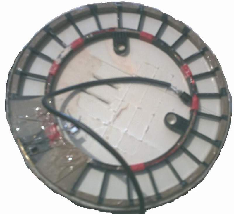

    So...
    I took chance to complete copy this coil datas and save for good!
    So, Garrett enthusiasts...you own me!
    65 turns (0.43mm with varnish) 0.4mm wire,
    58 turns (0.26mm with varnish) 0.23mm wire...
    Obviously it is DD coil.
    The rest of wirements inside is almost the same as on Scorcher coil.
    There is 680k resistor, few capacitors .....You should already been
    awared of Garrett coils arrangements....

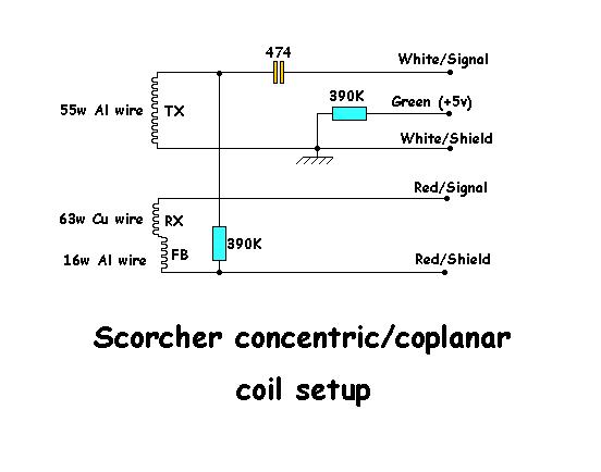

      I am a bit off this Garrett thing. Eliptical coil is
      busted. I used only plastic housing from it.
      All wirement was in a small bulky,glued piece.
      I started to pull out components and destroy all.
      But it is the same setup as on Scorcher coil.
      I have schematic of it here.
      Did i mentioned 680K resistor? Now i lost it somewhere
      and looking on this schematic i dont see it,just 390K...

      About taking photos....I have low resolution camera,no use from it
      for shooting details...
      But coil is made in usuall mannr, nothing special except very nice and
      tidy work...very hi-pro...
      Thats all from me for this subject...
      Regards!

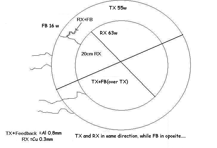

          It tokk me a while to find those photos trough 1200 cd's i have, with various schematics,photos...software...
          Here it is, fully cracked and measured....enjoy!
            TX
            TX diammeter is 29cm...omited on picture...
