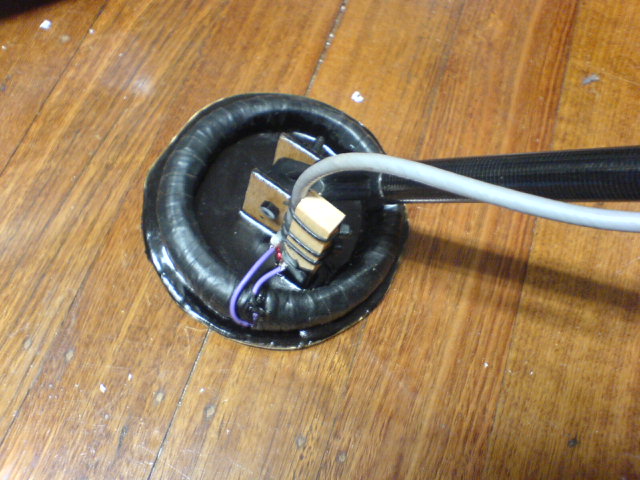

    There has been a lot of people tell me that Red clay is a real problem on detector depth, it seems that the Red clay either distorts or attenuates the flux lines. I carried out a test using red brick clay with a mix of soil and iron filings to make a barrier layer, I used an 11 inch coil and adjusted the distance so that I could just detect a 5 cent coin. Next I carried out the same test with a small 6 inch coil and the signal increased by around 20% at the same detection distance. This I think demonstrates that a more concentrated flux gets through these barriers better than with a larger coil.
    My thoughts on this may be utterly wrong, I hope more people try out various experiments so see if they can also get this effect.

      You are absolutely right. I have a range of coils I use on highly mineralized ground right down to 6 inches and have observed the increase in sensitivity on small nuggets using small coils.. It takes quite some time to search a large area using such a small coil so I only use the coil when I suspect that there a small deep nuggets.

        These small coils can punch down through adverse soil much better than a larger coil, even on a large target. I know of a place in Western Australia where a group detected over red clay and only got a couple of Nuggets on the surface, when they scraped of 6 inches with a dozer the found a few large 2 to 6 oz Nuggets that should of been detected in the first surface sweep. It has to be this red clay stopping the signal.
          I'm from the Pilbara region of W.A and we have plenty of red clay ( red loam) and it really prevents deep penetration. I had one situation where a 4 ounce nugget about 18 inches deep just sounded like a ground balance anomally. This ground balance signal is quite common. Many times have I dug a hole based on this signal and found nothing but red loam.
          Any way back to the nugget. I had passed my detector a couple of times over this section of red loam and got the ground balance signal. It was early on a summer morning and not too hot so I decided to do some digging. I scrapped of a few inches of red loam and the signal was more localized. Once I was down about 4 or 5 inches I knew I had something. After I got through the surface loam the ground was very hard and it took me close to an hour to dig out the 4 ounce nugget. Most happy.
          The other aspect of the red loam is that if you use a sensitive coil that works quite well in slightly mineralized ground it won't work well at all on the red loam. The ground balance response will drive you crazy. What I have learned is to listen to the variations on ground balance and this means increasing the threshold so you always have a background signal. Variations of this ground balance signal can signify the presence of a nugget especially on deep targets. This is the same for small coils also. However with small coils you are able to discriminate a lot better.
