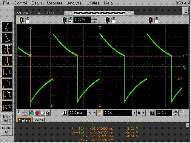

        'scope of Land Star TX
        Land Star TX output, 1k Ohm load (no coil)
        Last edited by Jeremy; 02-27-2008, 11:54 PM. Reason: Worse busted link - how to attach?
          TX output with 1k Ohm resistor, no coil. I was pinched for time in the lab but this is what I could do really fast. DC coupled probe, ground is center graticule. Opposite polarity pulses 27 ms apart.
          OK, I'll try pasting this jpeg one more time and then I'll shrug it off..
          See attached?
          Jeremy
