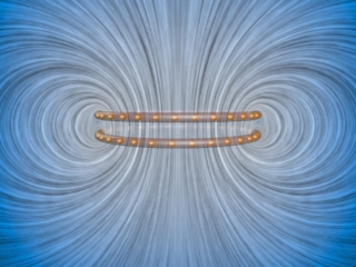

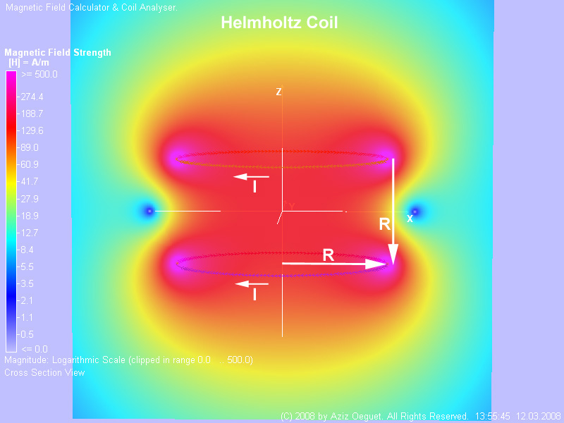

      See below cross section of the magnetic fields strength:
      In the inner side, the magnetic fields are almost homogeneous.

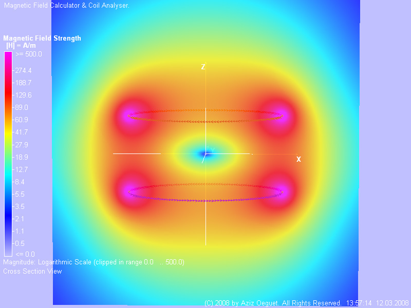

        If you change the current direction of one coil, on the center position there will be a magnetic "hole".
        I am sorry. So the proposed idea won't work.

          Now, could you show us how it would look if, with the current in opposite direction:
          1. The 2 coils are moved closer, until they are very close to each other, maybe in 3 steps.
          2. Reduce the current in the upper coil to 40%, 30%, 20%
          3. What would the maximum efficient diameter RX coil be,
          a) placed below the TX coil?
          b) placed inside of the TX coil?
          I hope this is not going to be too much work.
          Tinkerer

            The first image is what I was trying to describe, I would have the coils closer together (h < r ) so it's not technically a true Helmholtz coil. dimensions closer to standard coils, say.. 30 mm apart
            My question is If the Rx coil was placed in the null position (dark blue points) will it be able to receive emf from targets and/or distortions of the Tx fields.
            It seems to me that the uniform field strength of the configuration would also help S/N ratio.
            Will the large diameter Rx increase the detection area too???
            Aurificus
              Looks like have my answer.
              The null point between the two Tx coils is not an electromagnetic "black hole". That is an illusion of the graphical depiction.
              The magnetic field lines (lines of force) cannot cross, stop or start. They will become very close together and be of opposite directions even inside the structure of the wires in the Rx coil, creating an excellent but not "Perfect" null. Good enough for my purposes.

                Tinkerers pic, flattened Helmholtz coil.
                Thanks Tinkerer, I've posted this for anyone who comes in late.
