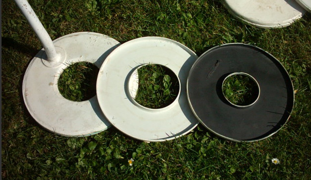

          • Hello Dave & and other friends !
            Dave writes : Ive never made a circular coil for a induction balance machine because they seem so complicated, has anyone here got some uncomplicated instructions to build one say for the TGSL most of us built here because it will be interesting to see the results, Ive made loads of DD coils with very good results, or at least I think so.
            Look at http://www.geotech1.com/forums/showt...7250#post77250 there is a zip called "form.pdf" here you can see the coils I made and used for ' in water' searsing.
            Have used the 22cm coil, with cable in tube, a lot with the Golden Sabre. Worked beter then a Fisher 1280, more depth and beter pinpointing by slow moving over targets.
            On land the opencenter is better then DD for 'Hunts' ,better pinpointing and disc.
            Have many time's told on Geotech how I made the opencentre coils ... I think they are easyer to make then DD coils.
            Just my story.. ( coils&forms etc. from +/- 1989 )
            Best regards to all.
            Ap

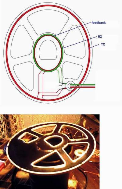

            • In the past i made just a few cc coils with more or less success.
              I had less knowledge than and lot of problems to make it right.
              That's why i adopted kind a fear of those!
              Than i gave up and switched mostly to dd coils.
              But recently i had to service one original Tesoro coil.
              Cable was extracted from coil by force, an accident.
              Deep inside coil wires were broken.
              I tried to remove epoxy filler somehow and that resulted with complete coil destruction!
              So i was forced to make new one, using original enclosure, which i managed to save somehow!
              So i made TX and RX windings easily.
              Feedback was a bit of trial&error job. Not a big deal. After second attempt i got it!
              But than i realised how easy making cc coil can be if things are done in right order!
              CC coil is not deeper than DD but it is more "stabile" and kind a easier to null.
              Once null is achieved by finding proper feedback specs - it stays perfectly nulled even if moved and knocked untill filler is applied and hardened.
              Unlike DD coil.
              At DD coil i have to pay attention on slightest move, knock, temperature change - before i apply filler and wait 10 and more hours to harden.
              Great chances null to slip away and jitter a bit.
              Not case with CC coil. Even without filler; it stays stabile nulled and immune to moves, knocks and sudden temperature changes.
              CC coil is more precise at pinpointing, a bit more accurate at discrimination and making it is not that hard task as i had fears in the past.

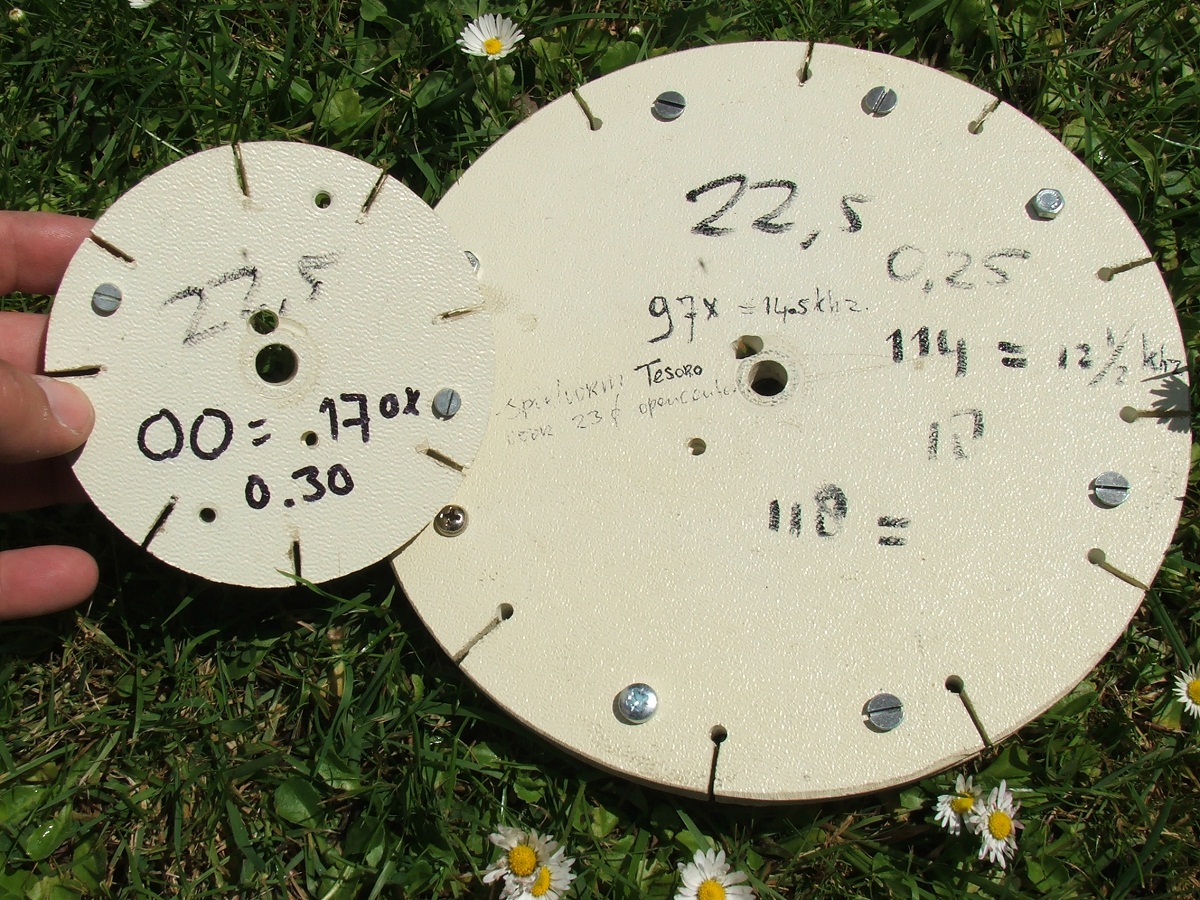

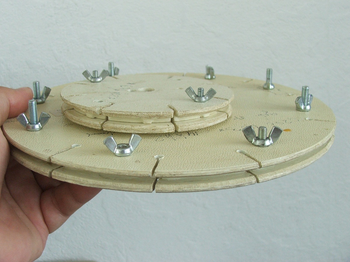

                  • Hello Dave,
                    Made some photo’s from the coilwindig forms I used… they are from late 1980’s …so no computer software then, but the made coils worked fine.
                    To make a CC coil :
                    Start with the transmit coil, as seen on the large 22,5 cm form 97 turns give’s 14,5 KHz, (114 turns is 12.5 KHz.) Wire used is 0.25 mm and the coil is connected to the Tesoro transmitter so the cap from the oscillator has also influence at the transmit frequency !
                    The first receive coil, 18 turns, is added at the 22.5 cm coil, same wire and turn direction . Transmit coil and first receive coil both clockwise !
                    This 18 turns will , just like in a transformator, pick up a part from the transmit signal .
                    If the transmit signal is 15 volts then there is 15volt /97turns = ca. 0.15 volt per turn wire so the first receive coils 18 windings pick up 18x0.15 volt = 2,7 volt.
                    Now the trick is to null out this 2,7 volt … this must be done by the second small receive coil, As the distance to the transmit coil is greater the magnetic field is smaller, so less volts per winding.. so more turns are needed to get that 2,7 volt. AND that voltage needs to be in opposite faze , so the windings for the second receive coil have to be counter clockwise !
                    For a 10-12 cm coil form some 160-170 turns are needed, also 0.25 mm wire. The two receive coils are connected in series but picking up the volts in opposite faze's so the result is zero.
                    If you have to move the small receive coil towards the transmit coil (stronger magnetic field) then you have to add windings at the small coil….if you have to lift up the small receive coil (less magnetic field) than you have to reduce windings…
                    For the receive capacitor look at the first opamps output… select the cap for a nice sinus out.
                    Good luck !
                    Ap
