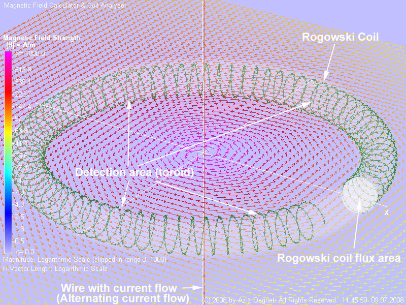

    Hi i would like to aska very basic question. Why the rogowski coil dosent sense the magnetic fields due the conductors which are outside of it??

    The answer is simple: the flux area of the coil is the sensing area. The flux area of the rogowski coil is a toroid and therefore not convenient for metal detecting.

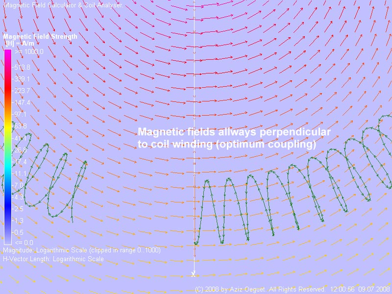

      Dear sir, AZIZ guru thank u for explaination. But if i dodnt go mathematically and see the flux of the outer conductor cuts the coil windings and it must be sensed by it how it cancelled out by rogowski coil?? Can you pls explain physically!!!

        Normaly, the rogowski coil is used to measure the AC current flow through a conductor (wire) going through inner of the rogoswki coil. The current through the wire causes concentric magnetic fields, which are covered and sensed then by the rogoswki coil. A voltage induction can be measured.
        For metal detection this coil type is really not convenient.
        See attached graphics for more infos.
        Aziz
          Addition to your question:
          When the wire to measure is outside of the rogowski coil, the total magnetic flux is getting zero. Therefore, it doesn't induce any signal from wire outside.
