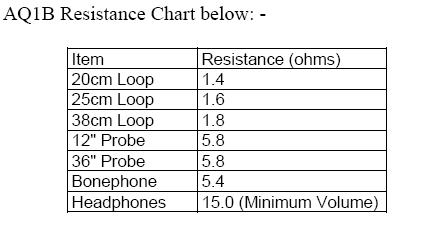

    You have to know the inductance of the factory coil (eg 38cm loop). You can understand it by a inductance meter or simply count the number of its windings and tell us, we will tell you the number of turns for a 1m frame coil.

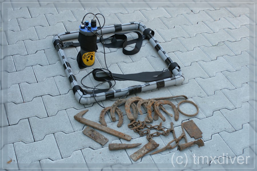

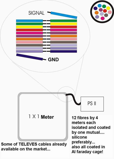

                  Hi to all,
                  my prototype of square coil for AQ1B is ready (50x50cm) and was tested today. I am very satisfied with the results, especially because the detector works very stable. You can see the results of the present day in the picture below. I have used 12 wire cable as compensated loop. Resistance = 4.2 Ohm. Further tests follow..

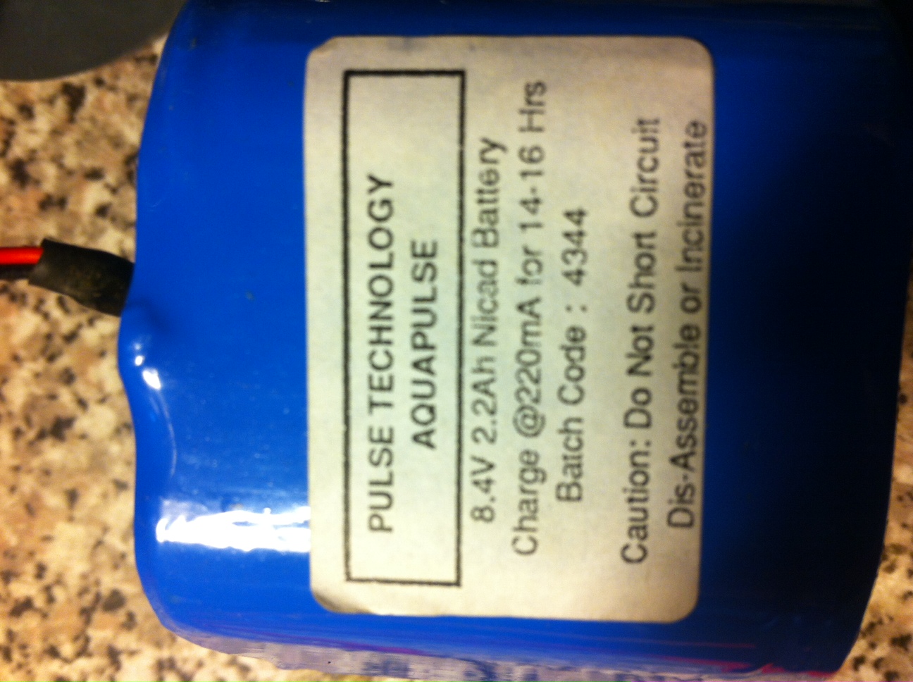

                      I also own this MD. Now i m trying to find out what batteries have inside, cause yestarday i measure it and i got 9.1 volts and after charged i got 9.8 volts. My charger is for Nicad batteries and this confuse me, cause i had understood that model AQ1A have Nicad batteries and AQ1B have Ni MH batteries inside. So if you or any one else can help, please let me know before opening the detector. The schematic will be of good help too.
                      About the coil, i have the 25 cms coil, that after measurements i got 1.8 ohms of resistance and 420 uH of inductance.

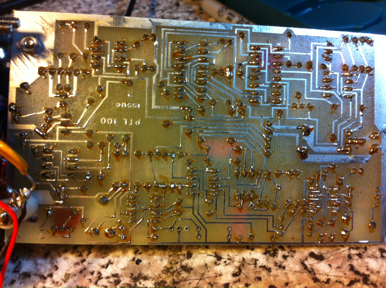

                        The Aqua Pulse AQ1B uses an 8.4V 2.2Ah Nicad battery pack. Looking through the small round holes in the top and bottom of the pack, I can see there are 7 C-type cells.

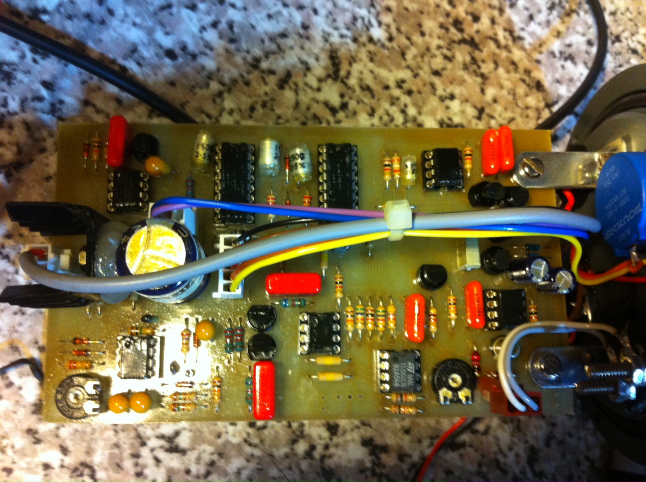

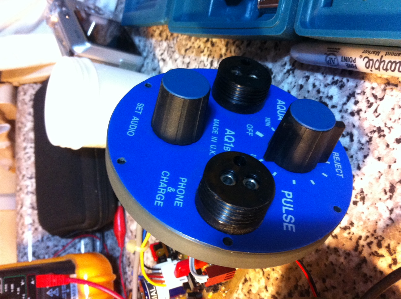

                          I did oppened my AQ1B and i found the pcb very simple, like surfmaster or may be less complicated. I took a few pictures from inside and also the battery pack that is the one you are mentioned.
                          My detector seems to work fine, but there is only one thing i´m not shure if is normal or not and this is the way it start to detect, The audio when you start to reach a target, it goes like is unstable sound with variations in tones and sound like unstability, i mean that you don´t hear the tipical tac tac tac that goes faster when you aproch to the target. While you are close to it, the sound gets very stable and sound goes up with solid and strong signal. However, in my first test, it shows that can pick up targets very deep.
                          My first test where done on my house that is very very close to high power lines and this sound looks almost the same when i turn on my XR71, getting a very unstable signal but no lost of deep. So my next test will be away from power lines, cause i can tell you that this MD is very powerfull.
                          Now i m looking for schematics, to have a backup in case the machine fails
                          Nelson
                            Here are some pictures i took
