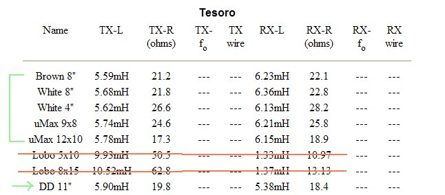

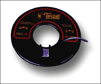

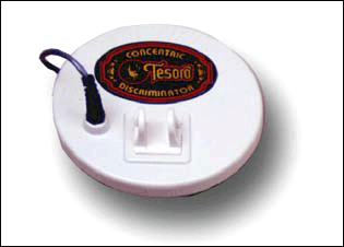

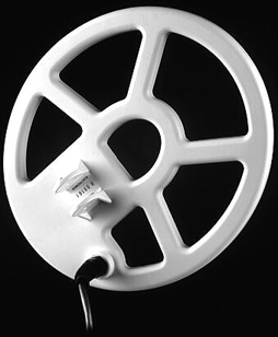

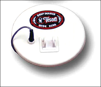

    I am now searching through a Library of thread's . So here are just a couple of items to prepare for my next posting on this New Coil Thread . Some small photos of Tesoro search-coils , which I am sure "Everyone" is familiar with. And a little chart below , which was posted by another Geotech Member several month's ago , with some Great information !!! The top left is the 7 inch concentric , the top right is the 8 inch concentric , the bottom left is the 11 inch wide-scan "double D configuration" and the bottom right is the 9 by 8 inch "Sinusoidal coil" which was designed to reduce harmonics .........................Eugene

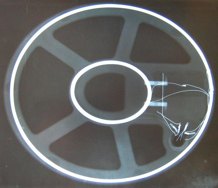

      Does anyone know what is inside the 9 x 8 sinusoidal coil? What is the very small inner circle?
        It's a concentric. The inner circle is the receive coil.
          Tesoro 8x9" inside (for Tejon)
          TX coil - inner diam. 201 x 229 x 3.5mm - 950uH / 4.3ohm
          RX coil - inner diam. 66 x 85 x 4mm - 15.8mH / 63.5ohm

            Hi to all,
            one can see on the inner coil the bucking coil and receive coil connections (wires). The thicker coil connections on top is the bucking coil and the thinner bottoms are receive coil connections. All concentric IB coils need a bucking coil. Mostly, they have same diameter of the receive coil (as in the x-ray coil picture). The transmit and bucking coil wire has same diameter thus same electric resistance per meter.
            Very interesting x-ray picture. Thanks to Mrand.
            Aziz
              Fantastic! Now I have to think how size of receive coil affects depth, and what would happen if the coils were reversed. (is there a reciprosity theory that says it's the same...)

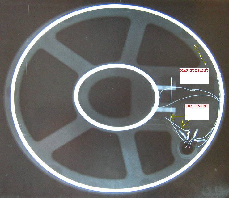

                this is really an interesting picture: the Tejon coil is not like in TGS cause inductances are different but I think the construction is , for other stuff, really close to the other 9x8'' (the white , for old uMax).
                I can see clear the RX coil leads (thin wires), the bucking coil soldered to the main outer TX and the heat srinking tubes at connections with cable.
                Also, MORE IMPORTANT, I cannot see any center tap...evidence there! Just I see the unusual shield connections ...2 of them around the main TX coil but NOT at RX ???
                That's really strange... but I think there's a trick...cause maybe the RX part, smaller oval at center is coated with some conductive paint.
                Anyone knows about?

                    another interesting thing is that seems there isn't a real lose loop... used for nulling!
                    Just a little more on tx-bucking coil connection side... but that's maybe enough for nulling.
                    I think their nulling is not so good cause of that!
                    I mean... they don't null at 1mV but fairly more.
                    Maybe the graphite shield overcome to the problem... and coils appear to be stable on soil.

                      I saw this probe exactly. She is done in such a way:
                      1. The case is painted inside with the graphite paint.
                      2. Windings are puting inside. They are glued tentatively with hot glue.
                      3. The probe is being very exactly zeroed by the change of the position of the Rx coil.
                      4. Windings are being flooded with the very hard resin for the 2/3 height.
                      5. The resin is being painted with the graphite paint. The paint is connected with the paint on the resin on the case. This giving full closure of the screen.
                      6. The case is being flooded to the full height with the black flexible resin.
                      In this way the probe is ready for the use.
                      In my opinion so is the manufacturing process, but I'm able to be mistaken.

                        I agree... seems the right procedure considering what they use.
