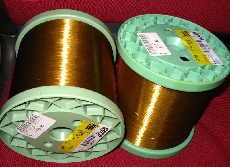

        Alu wire
        Hello Friends,
        So alu wire is used in coils? I bought some wire , tought it was a bargain at some sort Ebay (Marktplaats).
        Thinking that is was copperwire from 0.16mm ....but it is alu wire that looks like copperwire , it has the same sort coating
        Can't blame the seller they did not know ... I had to check ...
        Can always make some coils for testing, use more wire's in as 1 winding.
        But how to solder the connection? any idea's ?

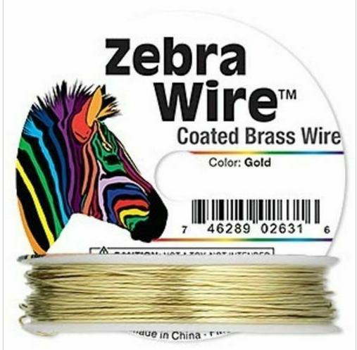

                            How about brass wire, would that work for a coil.
Name:	coated brass wire.jpg
                              Do not expect real brass wire.
                              It should be brass coated steel wire only.
                              Not suitable for coil windings (except maybe for very HF BFO coils due skin effect) due high resistance.
