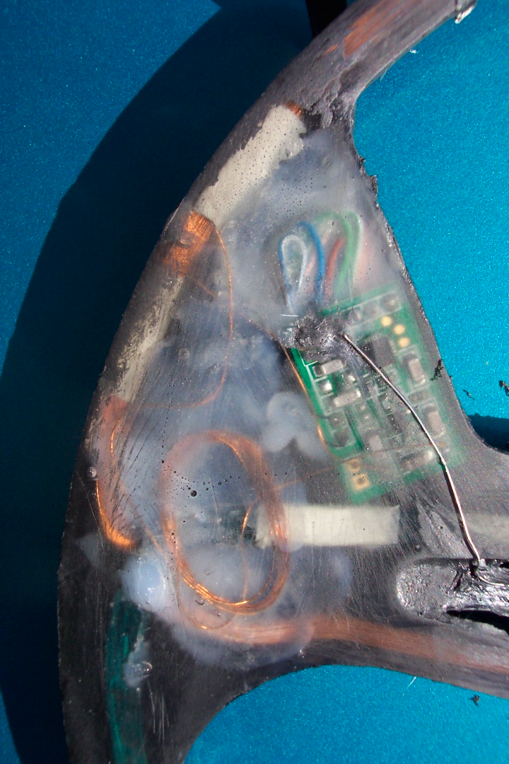

    I am needing a safe method to remove plastic from around electronic parts and coils without damageing the components. Anyone know a safe method. Thanks, Mark

      Clear hard plastic
        Is it really old? Some shellac derivative conformal coatings will
        dissolve in alcohol.
        A heat gun will soften many coatings, but if it smokes it's too hot.

          Is it blobbed onto the components?
          Try to wet one corner of it with acetone.
          Acetone will attack most plastics.
          Maybe you can get a start point and just peel or tear it off?

              PICTURE OF COIL
              PICTURE OF COIL
                Do you remember Alexismex's attempt to disassemble a Mineoro 210?
                Some of the "secret" circuitry was covered in black gunk, and I asked him how he had removed it. Here's his reply:
                I tell you my secret 70% to depotting all the epoxy and polyester, urethane and silicon resin ...USE cold (freeze) and hott temperature (500-600°) alternating , the resin brake gently very quickcly and many times the electronics resist very well (because the temp do not go direct to it, always the resine "brake" 3-4mm above the ic,resistor,inductor, etc...)...it is the essence of the technique, imagine the tools and you have the other 30% of the secret.you can see in the photo the scraped away in flakes and chunks.
                  Originally posted by swmomark View Post
                  PICTURE OF COIL
                  look at here:
                  http://www.youtube.com/watch?v=kTPXKA66baQ
                  don't know if is good for you... but an heat gun can help much in such situations....
