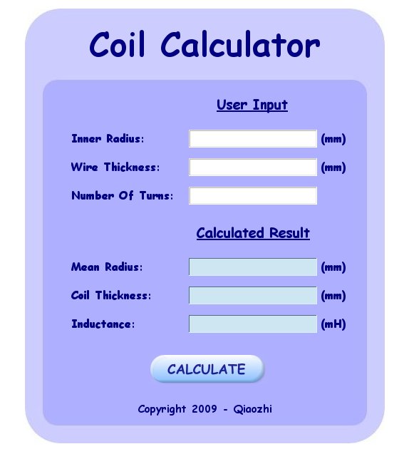

            I've put together a coil calculator written in HTML/Javascript and attached to this post.
            This calculator is based on Brook's equation, rather than the one from Wheeler, which is aimed at calculating the inductance of solenoids.
            A Brook's coil is a special case of a circular coil inductor of rectangular cross-section, that is designed to achieve the maximum inductance for a given length of wire. An ideal Brook's coil has a square cross-section and the inner diameter is equal to twice the height (or width) of the coil winding. However, these ratios are not critical, and you can have a coil that deviates quite significantly before the inductance moves too far from the correct value. I have found this calculator to provide more accurate estimates than the one's based on Wheeler's equation.
            The program will run under Windows, Linux or Mac using your preferred browser (Firefox, Internet Explorer, Epiphany, Sea Monkey, whatever). Double-click on "coilcalc.htm", or start the browser and open the file from there. There are no instructions, as it should be intuitively obvious ... famous last words.
            Any comments welcome.

                      Hi Tinkerer,
                      I've just tested the calculator with Google Chrome and it's working just fine.
                      Please see the attached image. That's what you should see in your browser.
                      You need to click on the big Calculate button at the bottom to get the results.
                      A couple of other points:
                      1. You must have True Type fonts loaded (could be a problem on Linux. In which case you'll need to install msttfonts). In particular it uses Comic Sans MS. Without this font it will probably look slightly different, but should still work.
                      2. The browser must have support for javascript script and have Active Content enabled.

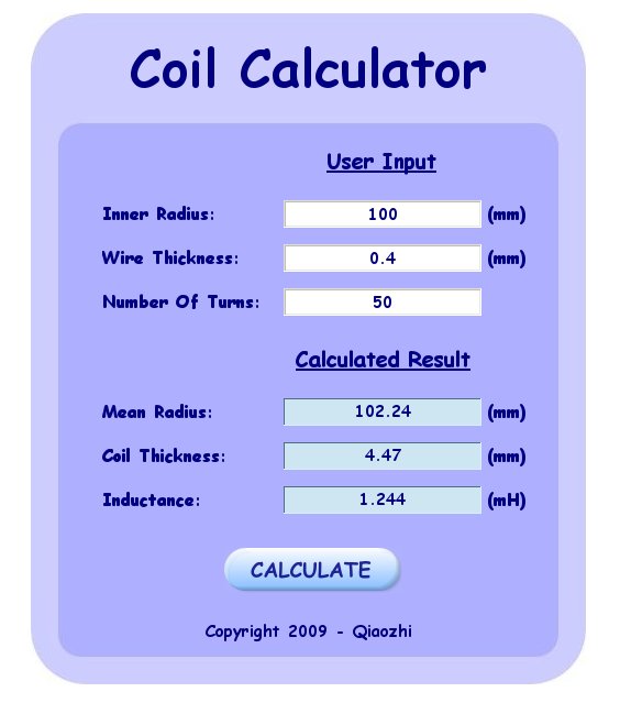

                          And here it is showing the results of a calculation.
                          Remember to be careful entering the inner radius. Don't put in the diameter by mistake.
                          Also, everything is metric. For you imperial types, there are 25.4mm in 1 inch.

                              I'm surprised you report that it over estimates by 50%. I've used this equation a lot, and it's reasonably accurate. What numbers did you put in the input fields?
                              Wrong ones!
                              Of course I put in diameter instead of radius.
                              Try again.
                              My coil is about 26 cm in diameter. About 111 turns. 30 gauge enameled wire.
                              D = 260 mm, R = D/2 = 130mm, Nturns = 11, wire thickness .2546 mm.
                              Lcalc = 8.111 mH
                              Lmeas = 12.3 mH
                              So now I'm back to underestimating by about 30%.
