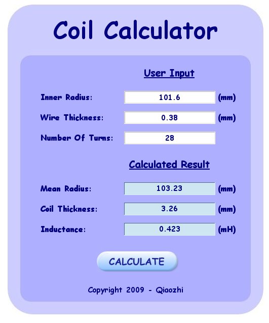

i need Construction of the search coil goldscan IV
goldscan IV coil
coils... here's very easy recipe
Hi,Originally posted by Ariubarzan_M View Posti need Construction of the search coil goldscan IV
the original coil was 436uH inductance with about 3.5ohm dc resistance.
Now you need a good inductance meter and a scope to replicate coil and setup e.g. damping in perfect way... but you can experiment too.
If you need an 8'' coil try this:
Use 0.38mm wire, 28turns will give you around 400uH, then around 2.85ohm resistance, that's not too far from expected value.
With such a simple coil, shielded with mylar stuff I got easy 1eur coin at 40cm on the air... but it's just about trivial coil... complex ones require much care and to be very careful at e.g. materials.

Using calculator:Originally posted by Max View PostHi,
My advice is you'll read (if didn't already) bbsailor's article on fast monocoils... then find teflon insulated wire! Also... if have scope and inductance meter things are well more happy!
Kind regards,
MaxAttached Files
I was just confirming that your calculation was correct.Originally posted by Max View PostI guess he has no Qiaozhi's calculator!
Otherwise... why ask for details... ?
Hmmm such calculator seems not like the one I have... but maybe yours is better , who knows ?

Originally posted by Qiaozhi View PostI was just confirming that your calculation was correct.
Get your copy here -> http://www.geotech1.com/forums/showp...91&postcount=6
Yes , I see... the calculator is pretty accurate... I made the coil starting from 30 turns, reducing number to get desired value that time... around 400uH as described.
