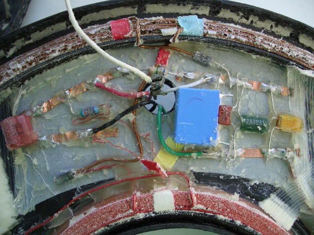

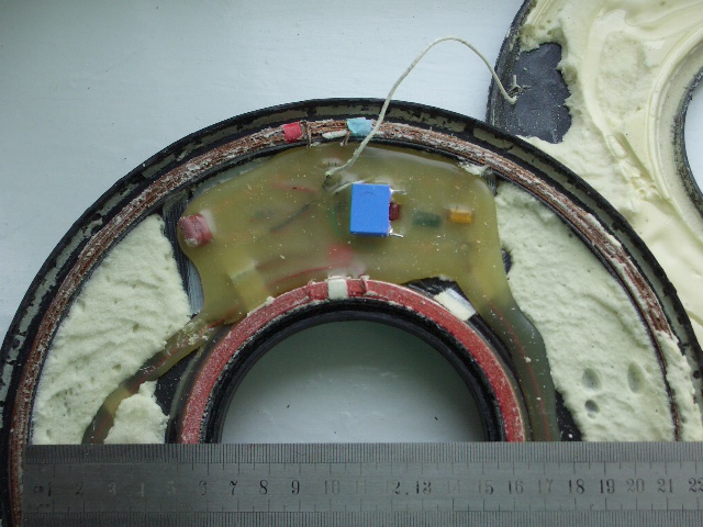

    I have problems with my concentric coil :
    the coil is 8"
    Tx=Fisher 1235
    Rx=White's classic III
    Rx capacitor=220nf
    plz. help - number of turns???????
    P.S. this is exelent md. with DD coil(silver denar-34cm in air) ,and I will sent shematic to forum after 20 april.

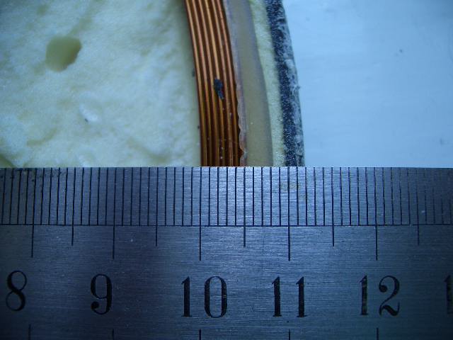

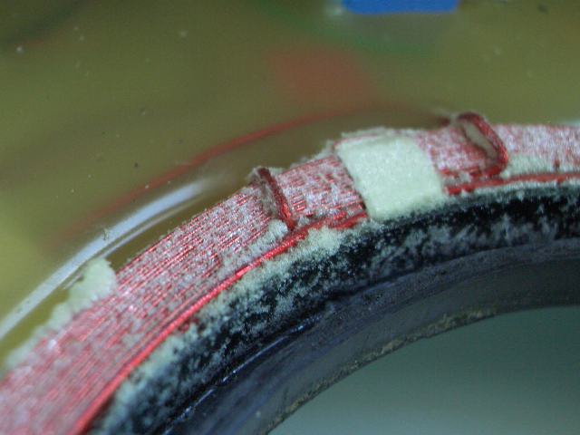

    hi. I can say on Spectrum coil 9,5, what I got now.
    TX coil has around 40-45 turns of 0,8-09 mm wire. TX feedback - one layer of wire of 0,8 mm inside RX. what about RX... it's some hard to say. 0,2-0,25 mm wire.

          XLT coil inside
            a way of shield contact in XLT coil
              schematic coil photo
              TX - WHITE, GREEN wires
              RX - RED, BLACK wires
              GREEN is connected to (-), BLACK goes to GROUND.
