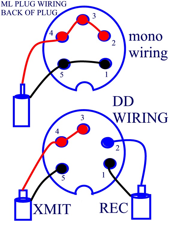

I am looking for some advice and information about coax for a duel field
coil ie what type. I have read that S video cable will work. I would rather not
use two lengths of standard coax. Is there a certain brand that is best to use? The coil I'm building is for a TDI so I am also looking for schematics
for the 5 pin connector and wiring within the coil itself.
Any help will be greatly appreciated !!
Thank You
Herb
