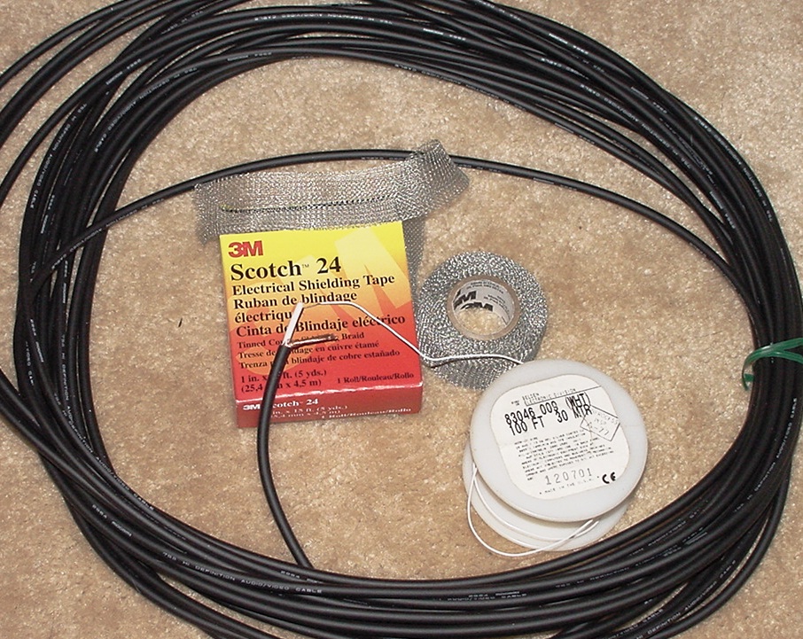

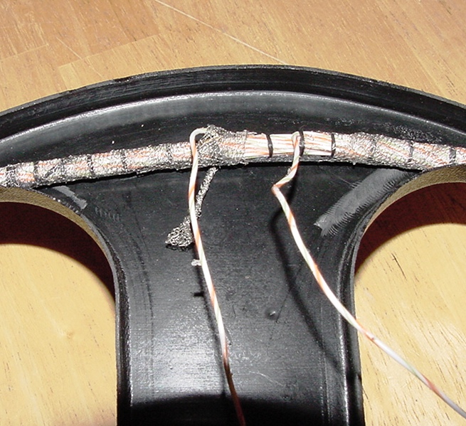

    I too plan to build a 1 M coil or larger. I have built several smaller one's up to 18 inches that have worked well and will do a 1 M next. I have some ideas but got all my guidance from a guy who goes by the handle "Reg."
    I have been using scotch 24 tape for my shielding but Reg says carbon paint for the correct resistance (low 25 ohms) could work but most carbon paint I've found is .8-1K ohm and silver paint looks to be too low?
    I used teflon coated wire 24-26Ga wrapped with archery serving string (it's waxed) and makes nice half hitches and wrap as tight as possible. Once I complete wrapping with the half hitches I spread silicone II over the coil. I don't think I will pot the coil when I make a 1 M coil as I think it would be best if it remains flexable. However I plan to also wrap it with a foam wrap which will help protect the wrappings. Probably best to read Regs suggestions and my info at: http://www.geotech1.com/forums/showthread.php?t=15459

        Hi Slick,
        I have not build Gary's PI so you might want to check with him to see what he feels would work best. What I have seen is he seems to like to build his coils flat single layer types. Again, I have not tried that design so I can't tell you what to expect if one were to compare the different coil designs.
        Now, you can scan this site for a lot of ways to build coils that include simple winding techniques, to basket weave, single layer, etc, etc.
        The best way I have found is to simply try differet ideas to see what fits your requirements the best. Only you can decide that.
        Now, Terry gave some basics that will work and is simple to do.
        You asked a question about shielding and whether is it necessary? That depends upon what you will shoot for as your minimum delay. The shorter the delay the greater need for a shield. Since shielding really isn't that much of a rocket science, one can try both ways.
        Now, if no shieldng is used, then you will probably have to operate at a longer delay setting to avoid excessive false and erratic signals. This is fine for the iron and stony iron meteorites, but may not be the best for the stony types. Since the stony make up about 95% of the meteorites that hit the earth, that is a lot of meteorites to ignore.
        Reg

                        All I can tell you is what works well for the TDI: After I wrap a series of half hitchs the length of the coil I spread Silicone II over it and immediatly wrap 1 layer of slightly overlapping scotch 24 tape which is not really tape but a thin wire mesh. I honestly thought it would be too much shielding but the coils respond very well and provide great depth on the TDI. Attached is a pic of the tape. It has to be cut however is it comes in the form of a flattened tube. I just cut it down the middle lengthwise and spiral wrap it leaving a small gap and ground one end.
