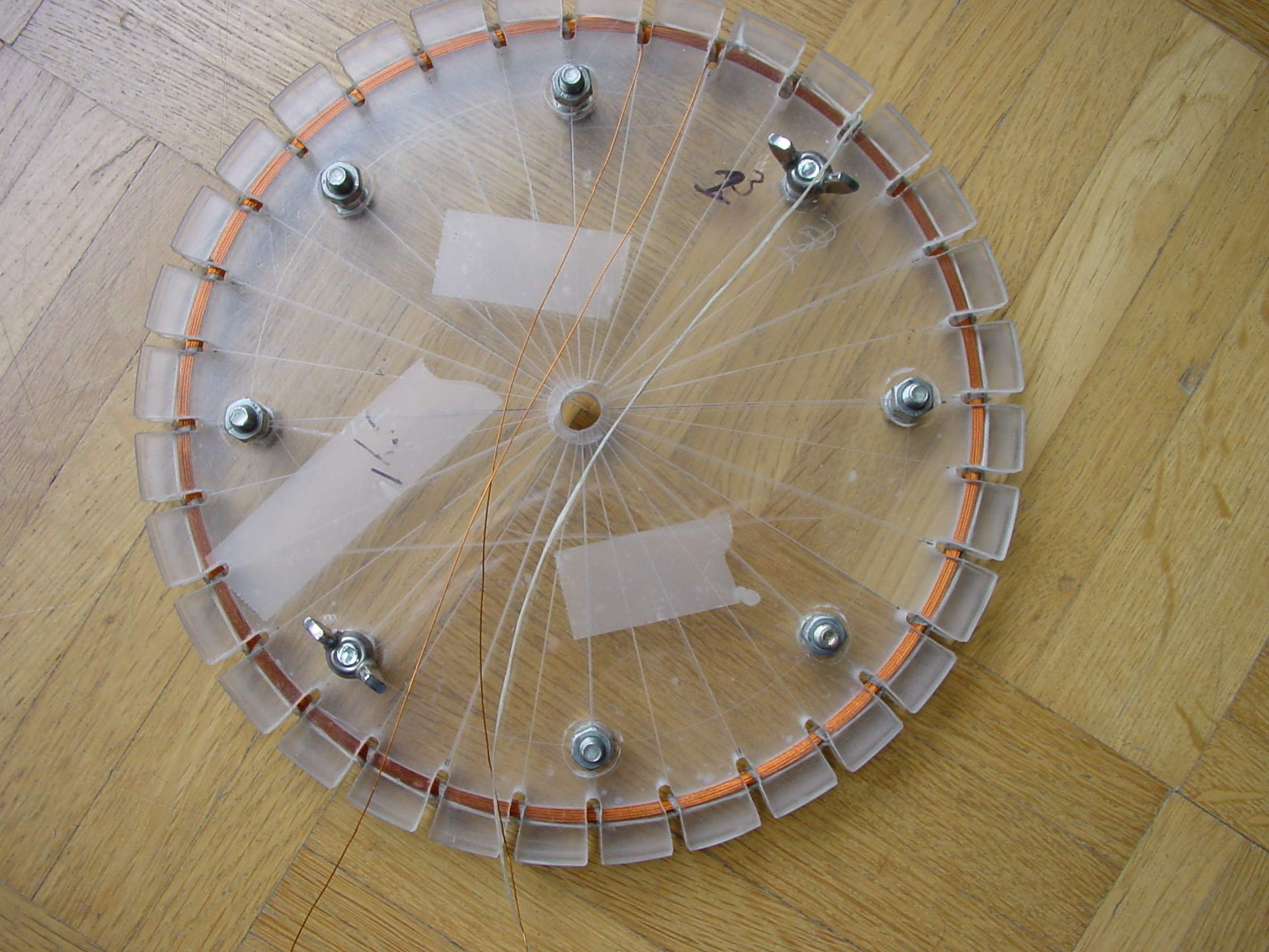

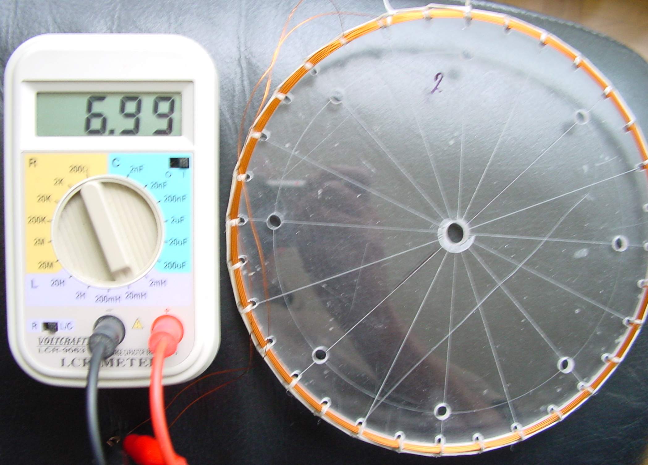

                    Qiaozhi you are right,second one is more accurate .Grt Nakky.
                      80 / 0.28 / 130 =7.147

                        That's a pretty cool looking coil form, can you tell us about it?
                        -SB

                          If you were to bind the windings with tape, it would cause the inductance to increase further. In that case the two values would be even closer.
                          I think the calculator is now working perfectly.
                          Thanks for the feedback.

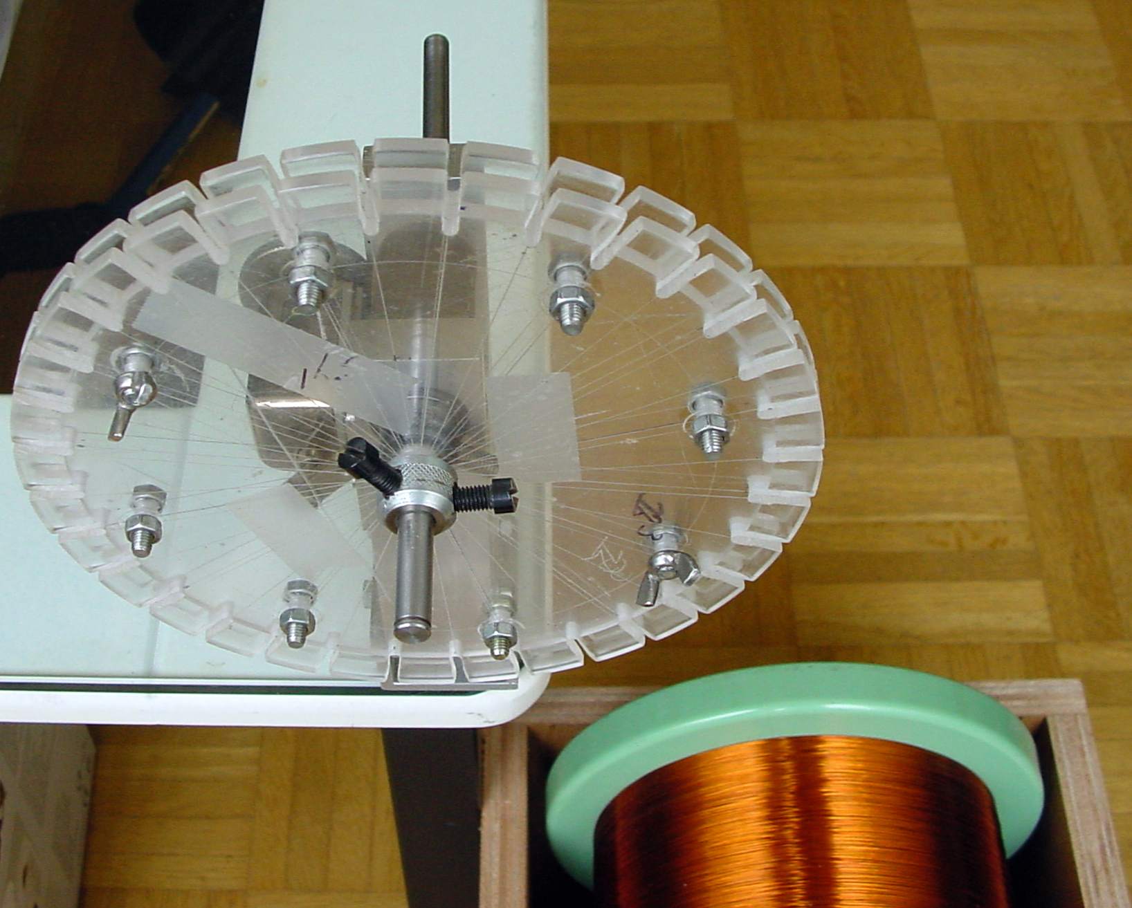

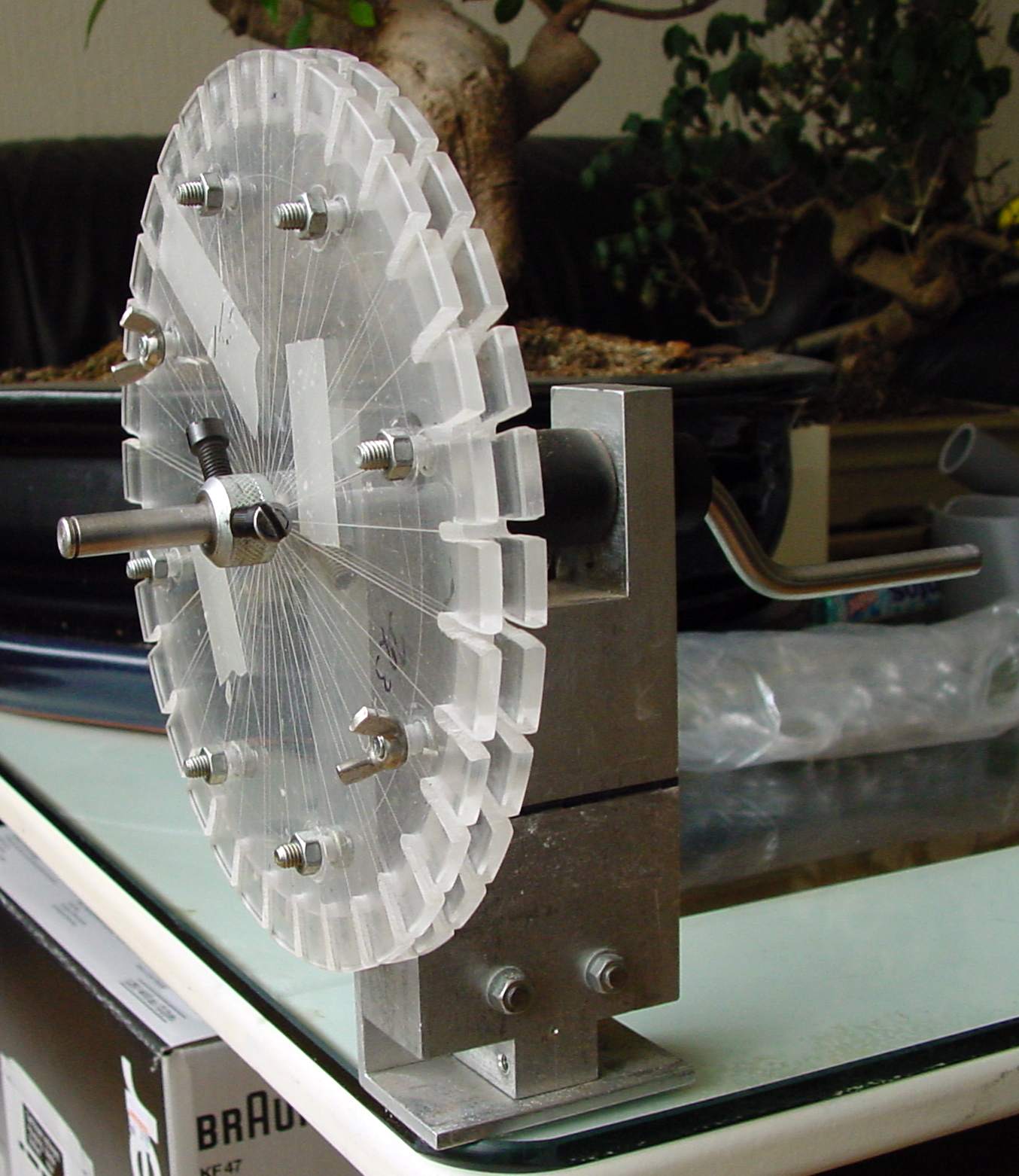

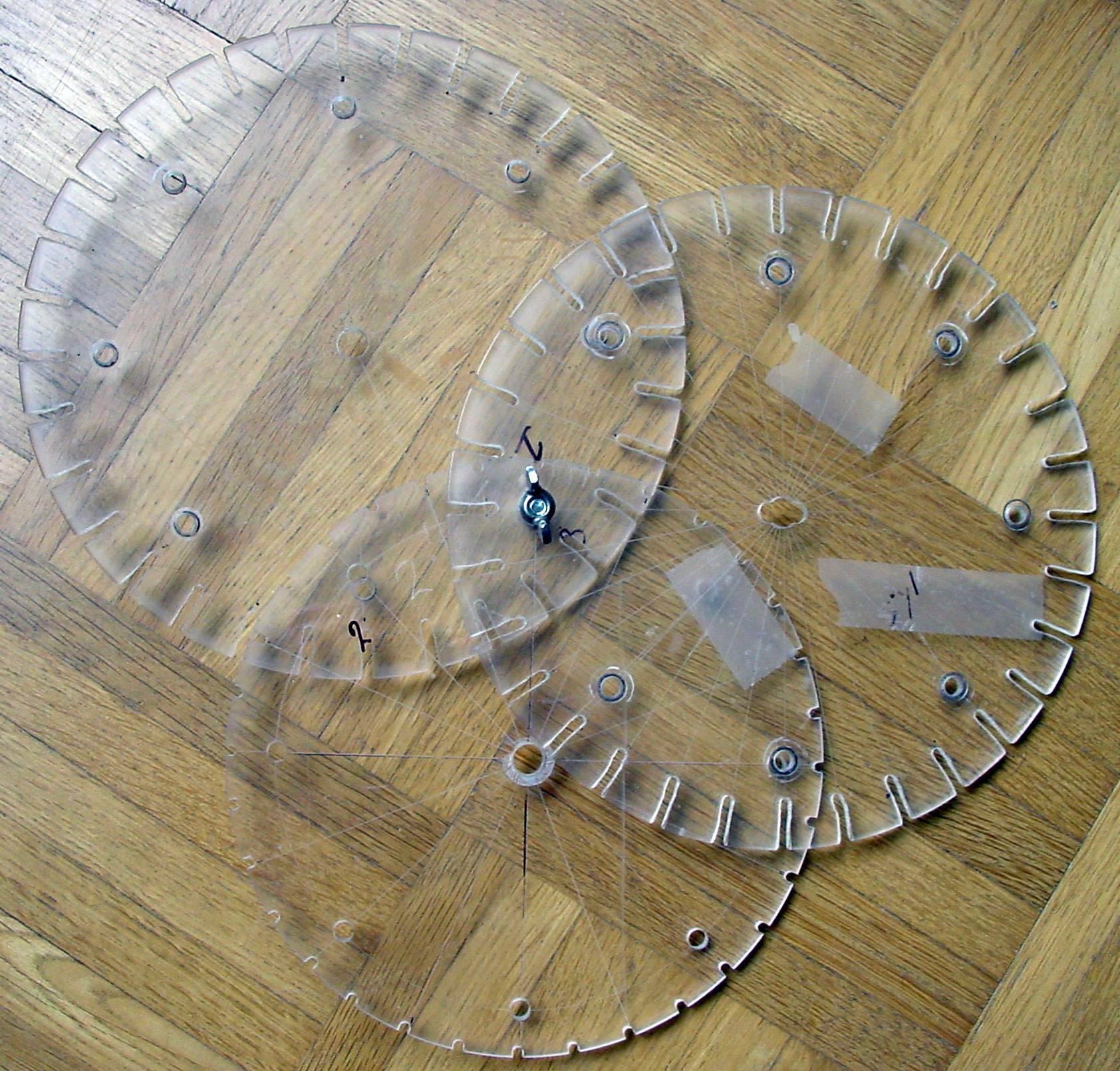

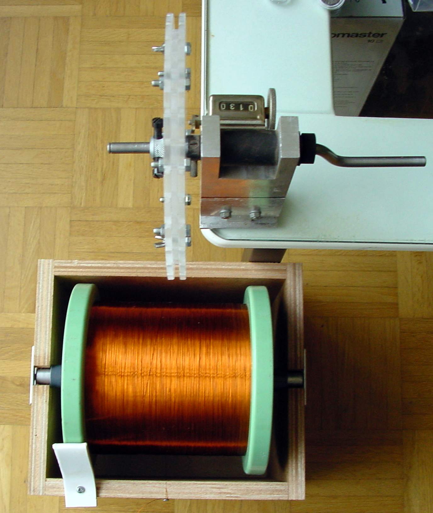

                            Simon ,my english is poor,maybe my pics are better.Grt Nakky.
                              coil winder

                              Ha ha ha! That is dream come true!!! Very excellent!
                              I have not found a way to quickly "bind" the coil with thread -- it is slow.
                              I can use plastic "zip-ties", fast and easy, but too thick and cost money.
                              I need a special way to tie a good tight knot with thread quickly many times.
                              Nice machine!
