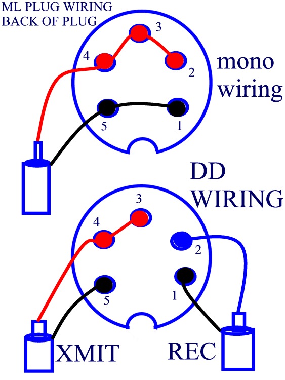

    I've been reading the schematic for HHII and it seems pretty clear except I was wondering if the value selection for the recieve coil damping resistor uses the same procedure as for the xmt resistor. Should the recieve coil have the same inductance value as the xmt coil?
    Hi Mike,
    First lets discuss the receive coil. Now, I have built DD coils with the receive windings ranging from 300 uh to 450 uh and all worked fine. I am inclined to use the higher value now because it does give a little more gain and with the inductance different than the transmit coil, there is less tendency for interaction. I use a 300 uh transmit winding. This allows me to use factory coils with minimal changes since they have a 300 uh transmit.
    The HH schematic provides for the damping resistor to be placed on the board. However, mounting the receive coil resistor on the board leaves it in place should you decide to use a mono coil later. This can interfere with the use of factory coils since they already have a receive damping resistor inside the coil housing.
    If you use a multi pin connector then you can use different pins for key connections and by duplicating a common arrangement allows for the use of other coils. This will also allow you to use either a mono coil or a DD coil much easier. Now, if you add the receive damping resistor in the coil housing like what is done on factory coils, then the connection or change in coils becomes transparent.
    Many people are using the 5 pin connector similar to that used for the Minelab PI compatible coils. Doing this will allow one to use Minelab PI factory made compatible coils with ease.

        Hi Mike,
        Minelab uses a simple 5 pin mic connector.
        I have attached a pic of the connection to the pins. Also, here is a link to a pic of the connector used.
        If you look at the pic of the wiring of the connector, you will see the shield of the coax's connect to pins 1 and 5. By connecting pins 2 and 4 will allow the transmit coil become the receive coil also. In the pic, pin 2 is the receive connection, while pin 4 is the transmit coil winding connection. So, to use a DD coil, the transmit coil of the DD will connect to pins 4 and 5, while the receive winding will connect to pins 2 and 1. Pin 2 can be connected to pin 3 also if one desires. However, pin 3 really doesn't do anything that I can tell except make it easier to connect pins 2 and 4 when wiring the connector for a mono coil.

            Hi Mike,
            First, I noticed I didn't answer your question about the damping resistor for the receive winding. I have found I can use about a 1.2K but have bumped this up to a 1.5K and as low as a 1K resistor on the receive winding. So, it is a matter of experimenting more than anything and will be dependent on the final receive inductance as well as the wire used. The less capacitance involved the less resistance required. This is true for DD's and mono's.
            As an example, lets say you are building a 300 uh xmit mono coil and trying different types of wire to see what happens. If you set the damping resistor for a higher value, maybe a 1K to 1.5K and test different coils all having the same inductance but made with different wire, you will get a better idea of what I am talking about if you observe the waveforms generated. A coil with very low capacitance will dampen nicely while other coils will oscillate and require a lower value of damping resistor.
            Now, this is a little trick in the fact that using the best wire will allow a higher value of damping resistor, which then will allow for a faster decay. With a faster decay, one can sample sooner. This becomes important for someone wanting to find small gold.
            Now, I have tried tweaking a coil by adding some damping resistance to the xmit coil inside the winding, but I have never put all the resistance there. However, if I want to experiment with a wide range of xmit coils, then something should be done with the damping to obtain the best results. Simple experimenting will best show you what will happen.
