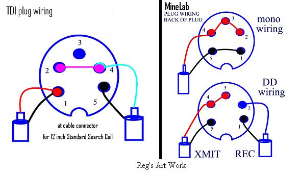

    Good day all. I hear how the TDI can use any and all SD, GP or GPX search coils available; therefore, did White's Electronics design the TDI to accept these coils or is because the connector is the same and everyone is plugging the coils up and giving them a try? Because Jeg's artwork shows different wiring at the connector for MineLabs. I copied from Reg's artwork to show the TDI's wiring and it is way different.

    Cool. Well, wherever you go...there you are and TDI can use some MineLab coils, too. Using different coils is still a buy-and-try or a-hit-and-a-miss unless someone can say for certain that a paticular coil worked better. I'm gonna stick with the standard coil for now, will consider a Jimmy Loop and will build a larger mono some day. Being that the wiring is different at the connector it would be nice to see how a TDI Dual Field search coil is assembled.

        Greetings, Reg.
        Since the connectors are the same I can plug my ML coil in. I can easily give it a try and see what the DD does for me. While the wiring is different at the connector both do use the same 1,2 and 4,5 pins. The exception is pin 3 for TDI as it is not used at all. In constructing a coil I will jump to pin 3 so I can use it on ML as well.

          Hi Whiskey,
          I wouldn't jumper pin 3 to anything. It really isn't needed as far as I can tell. I have tried various coils including a ML coil, a couple of Coiltek coils and a Nugget finder on my TDI and Gs 5 and all work fine.
          Now, building a coil for the ML is a real pain, but extremely easy to build one that will work on the TDI.
