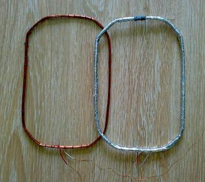

      Nice pic of two coils. The shielded coil looks done and might make a decent mono coil if the shape works. Not sure of how much of a performance hit the shape is going to cause.
      But, why is it being paired up to the other coil. Is a DD type coil being made? If so, then why shield the one seperately? Don't both coils have to be within the same shield for a DD?
        I still have a feeling that most mysteriously "bad" coils that were built basically to correct spec could be made to work well with some kind of compensation - just don't know what it is at this time.
        -SB

              DD coils not in same shield -- where get that idea?
              Also need to investigate real value of shielding TX coil -- proof by experiments.

                DD coils not in same shield -- where get that idea? ~ Production search coil assembly. TX and RX within same shield.
                Also need to investigate real value of shielding TX coil -- proof by experiments. ~ Shielding providing too much capacitance? I dunno. Is investigation now removing shielding in question? Choice of shielding type and quality may be of value. Maybe, I still dunno.
                This thread will come back if/when actual experiments done. ~ Someone better get busy. In the mean time I'll stick with backwards engineering.
                Now that I think about the coils pictured, they remind me somewhat of the BigFoot design for Jimmy Sierra's product line. I can't say about the shielding, but the design may be of interest. Slim them up a bit, maybe? Sounds like another test. Good thing wire is cheap. Best not to use cheap wire.

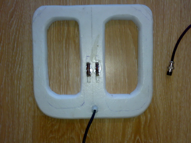

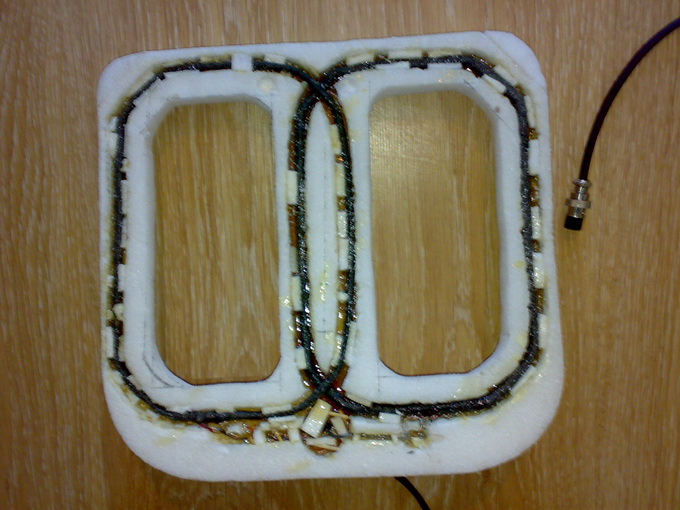

                        Greetings, friends!
                        Diameter of the coil about 8 inches.
                        Criteria: 1). Pressure of a food (8 volt – TX about 50 turns, 12 volt – TX about 80 turns, 18 volt – nearby 90 – 100 turns), RX in 1,2 - 2 more turns and more thin wire).
                        2). Frequency the above, the is less than turns TX.
                        This gauge for Fisher 1266. The template is taken from article –
                        http://mikes.front.ru/str2_3_e.html
                        Held preliminary testing – result 0,3 mv on RX (peak value). Dime USA – "catches" in 14 inches (in air).
                        The zero is cancelled: 1). Distance change centre to centre coils.
                        2). Introduction of a compensating coil in TX the coil.
                        Now it is necessary to fill in a gauge part «epocsid» with pitch, then again to arrange and again to fill in.
                        Toothpicks are necessary for time adjustment of the coil.
                        MikeS

                          Please keep posting the pictures while nulling and sealing the coil.Its interesting.
                          I couldnt understand what you say.
                          How you null/compensate coil?
                          And what is this tird coil in the article used for?And how?
                            Greetings!
                            Promised to show gauge fabrication stages.
                            Look!
