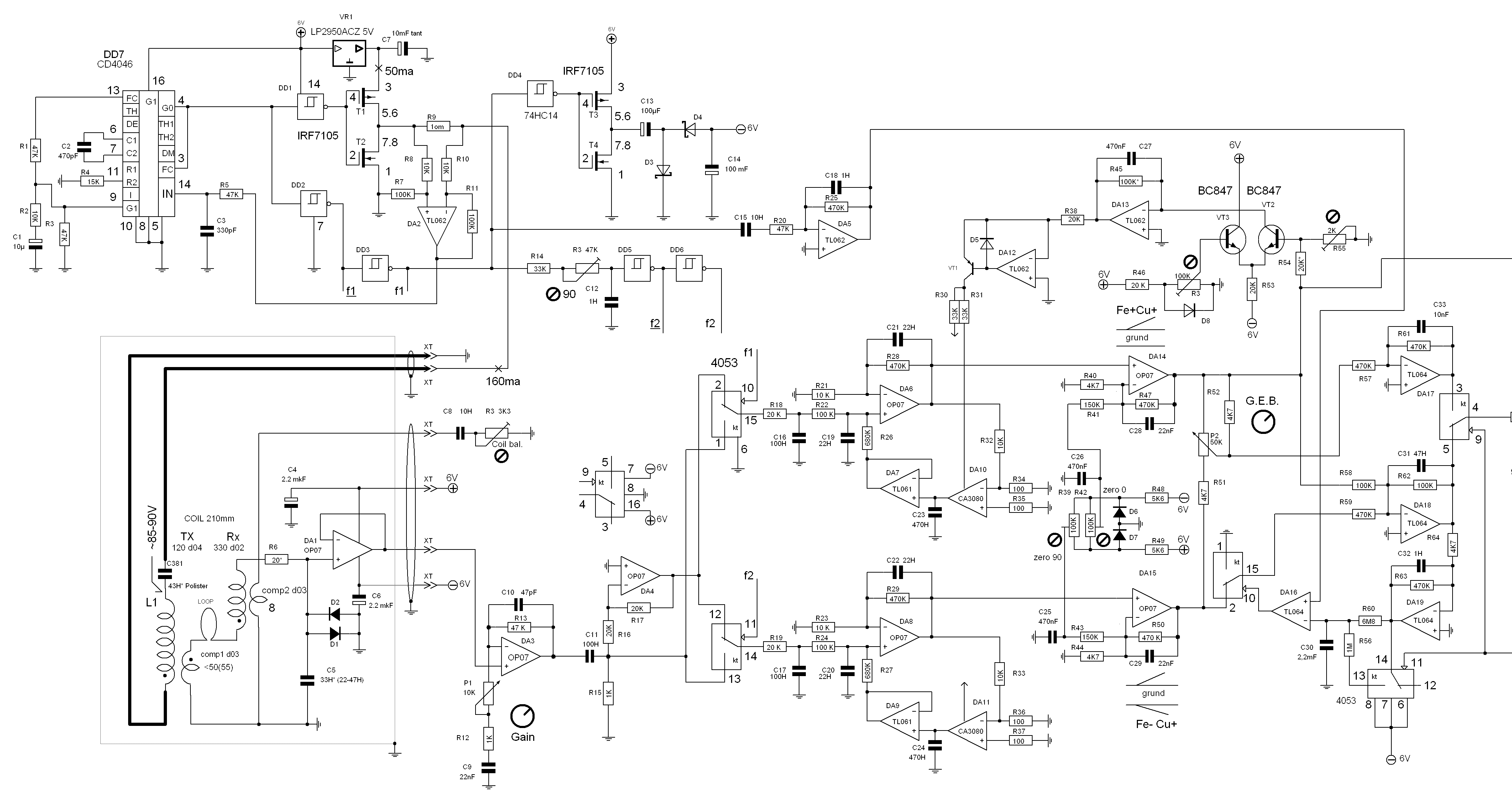

              Could you repeat to me please the schematic of a good tesoro coil ?
              thanks ! I still have some difficulties to optimize it precisely
                new release of Ciklon
                hi tesoro mMax lovers,
                I do not have a schematic of coil. sorry! I think it's very standart planar coil many times discussed in the forum.
                WHAT i CAN really:
                I can give you new schematic of ciklon. it was been made of him and working. it has an autotuning GEB feature and adaptive channel. absoliutely new release!
                sincerely yours, kt315
                  schematic of a coil
                  i take it from Ivan Kostin's site...
                    Re: new release of Ciklon : schematic don't display???
                    the schematic don't display: perhaps too big file???

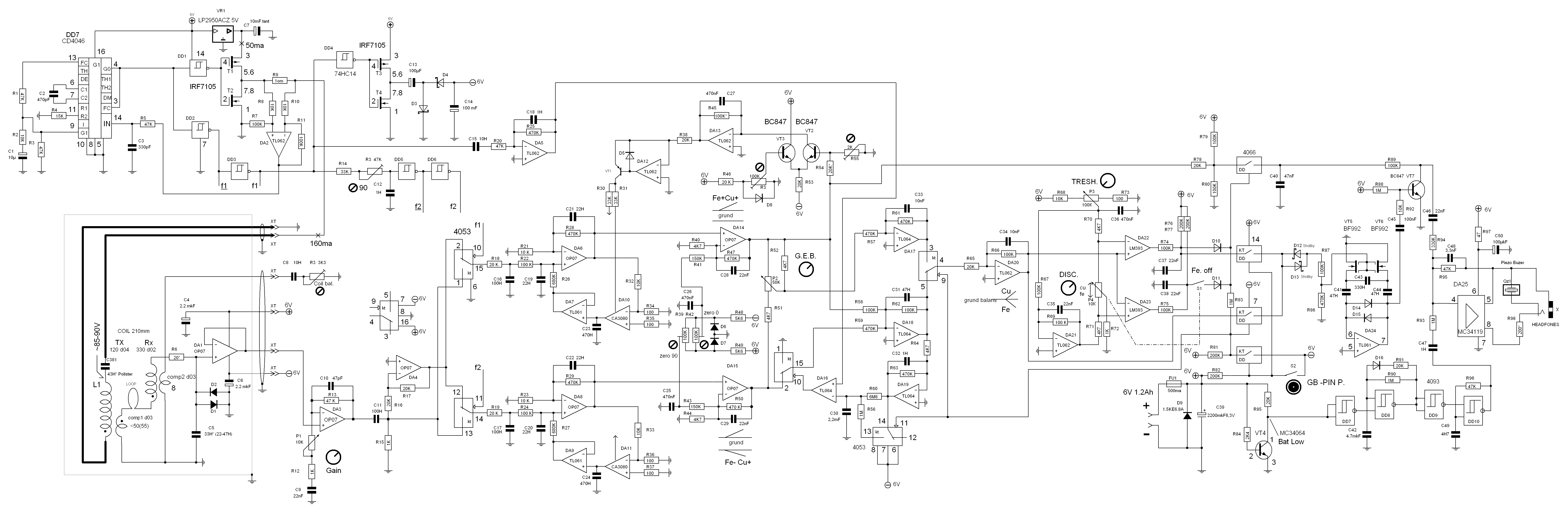

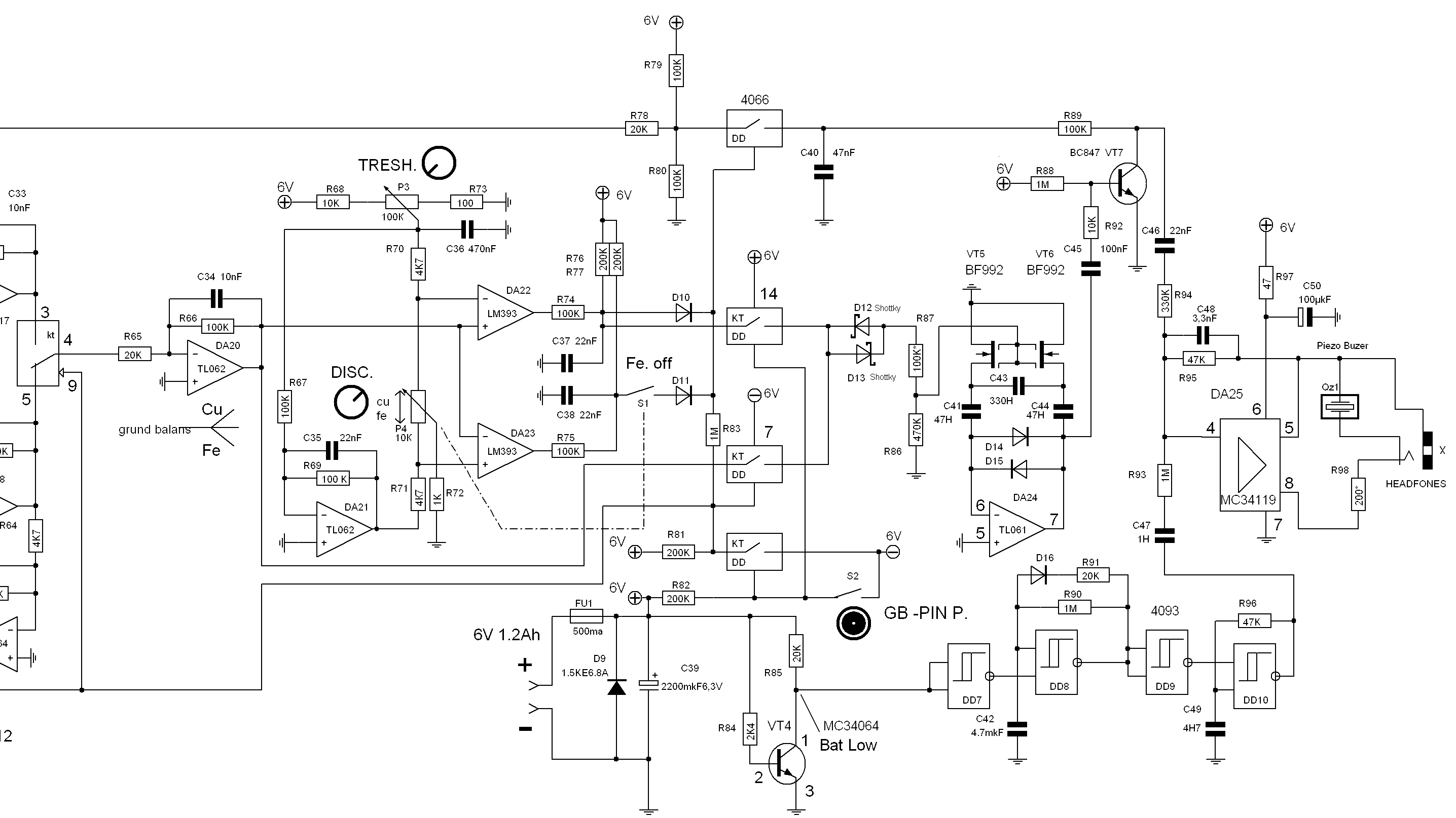

                        i try split it... part 1.
                          PART 2.
