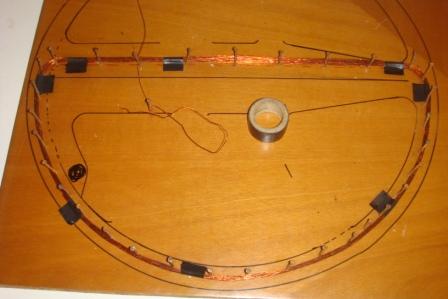

    Hi.
    I want to make a 15'' coil for my Sovereign ST. Prototype Inductance is 1010uH as i measure with my inductance meter. So i need 39 turns for my 37cm Coil housing. But when i will put the foil for shielding, the inductance will change.
    Knows somebody how many changes the inductance, so to calculate the coil exactly????

    Geo,
    Adding the shield will make the inductance a little higher. As you wrap the coil and squeese it tighter the inductance will also go up. If you wind the coil with one less turn you will reduce the inductance by about 58uH per turn for your coil. This is based on my quick calculation but only in the range of 36 to 39 turns.
    Also, as you change a round coil into an oval coil or "D" shaped coil the inductance will drop slightly. Try putting the coil in it's final shape before taking measurements. I suspect that each coil is actually about 11" (about 280mm) in diameter to fit the DD coil housing.
    Try one less turn, shield the coil, take measurements and post the results.

        Hi bbsailor.
        Yes the round coil has about 5...7% more inductance than the oval.
        I made the Tx coil with 40 turns and it is 1250 uH. I did not fixed it so i will take some turns. If with shield the inductance is going higher then i must remove 5 turns, but i have the opinion that the shield decrease the inductance of the coil.

            3% at 35or 36 turns is 1 turn. So, not so big important if it is 1.65 or 4.4%... i will revove again 1 turn.
            Thank you

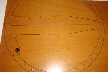

              Finally i removed 4 turns. Now with 36 turns coil has a Inductance of 995...1000 uH. It will take other 20...40 Uh from the shield, so it will go at 1020...1040uH. It is OK for the 1010 that has the original coil.
              I used 0.40mm wire (i had not other more thick). I read somewhere that for the Tx power of Sovereign it is good to use 0.45mm wire, but i think that the difference will not be so big. Now i want to make the shield.

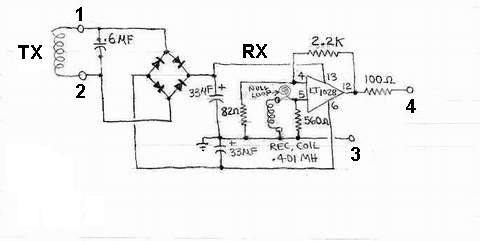

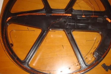

                            Today i had not how to spend my time and i opened the original coil (Tornado 1000). Maybe tomorrow to post some photos because it is a interesting coil for it construction method.
                            I revoved the amplifier but i lost one SMD resistor so i don't know what it is. Amplifier use the AD797, so if somebody has this schematic, please post it here....i want to check the amplifier and to put it in the new coil.
                              Geo,
                              Here is the Sovereign preamp schematic.
                              bbsailor
